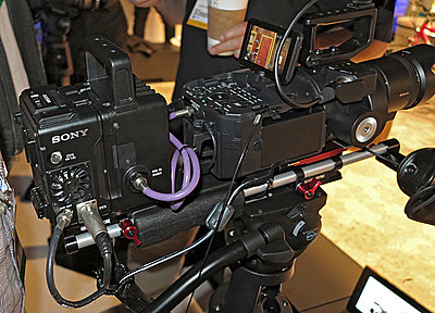

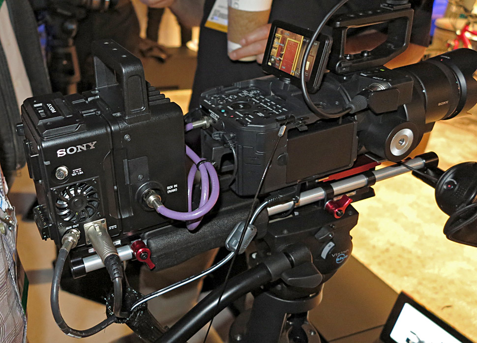

I addded up the entire package and it came to $19,669.
FS700 with 18-200mm lens $8,100, HXR-IFR5 interface $2,500, AXS-R5 Recorder $5,350, V-mount battery for recorder (BP-FL75) $540, battery charger (BC-L90) $829, AXSM Card $1,800, ASX-CR1 USB 3.0 card reader $550.
For should-mounted use, all that extra weight should help balance out the camera.
