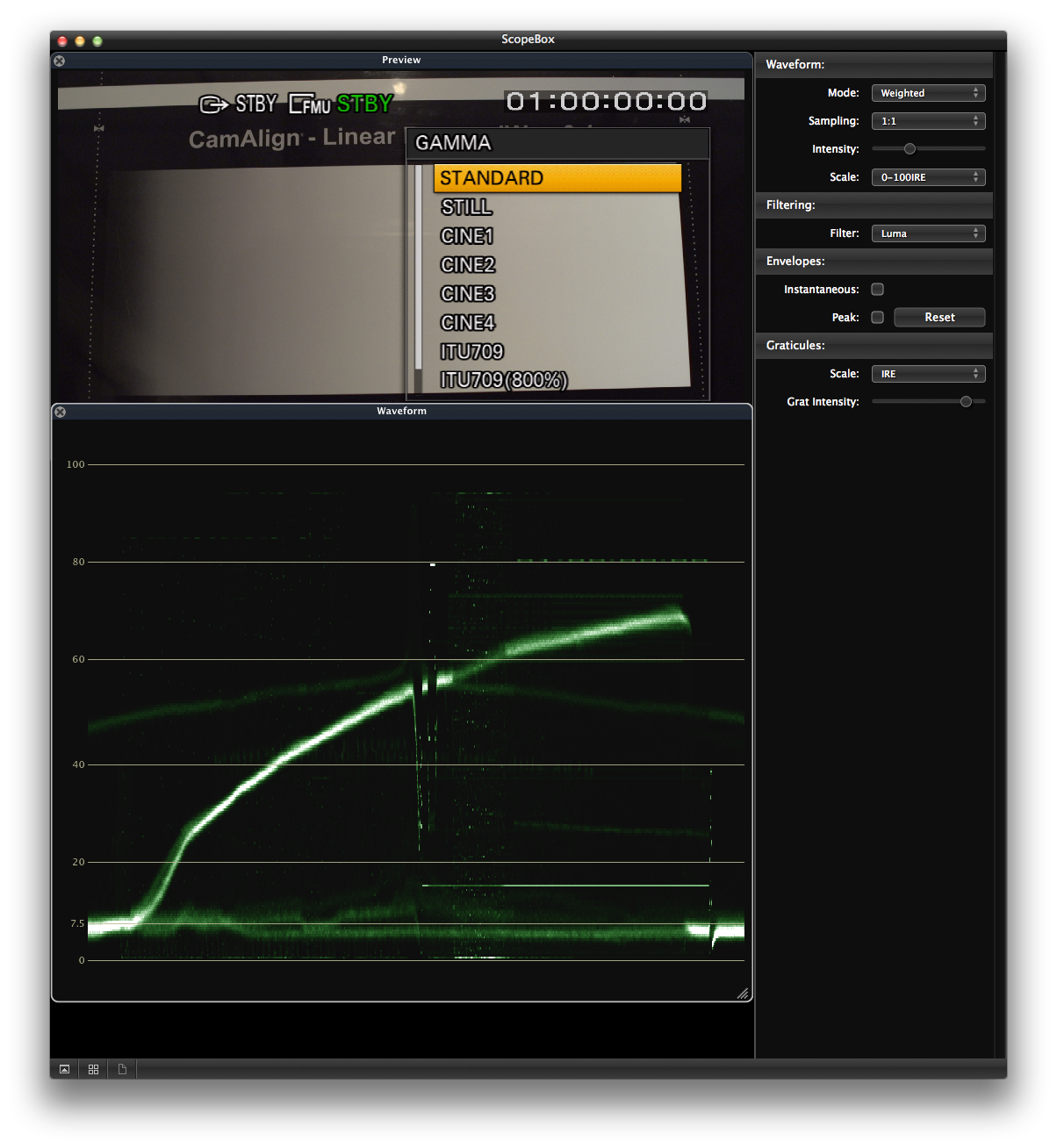

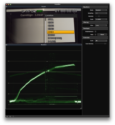

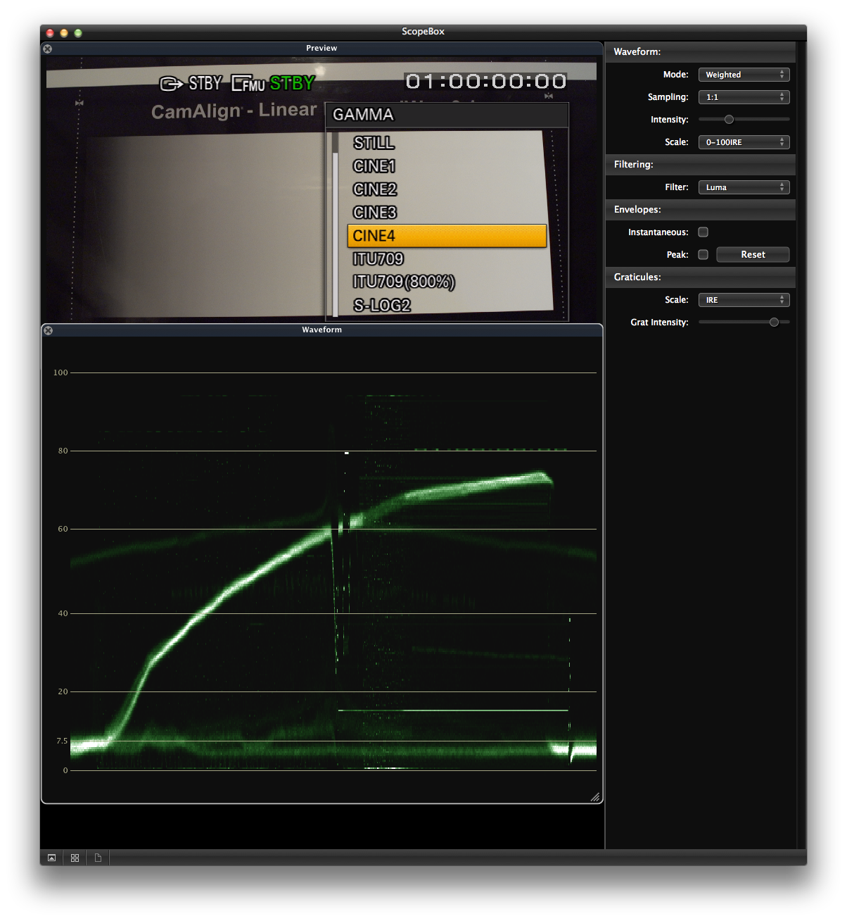

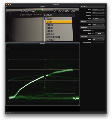

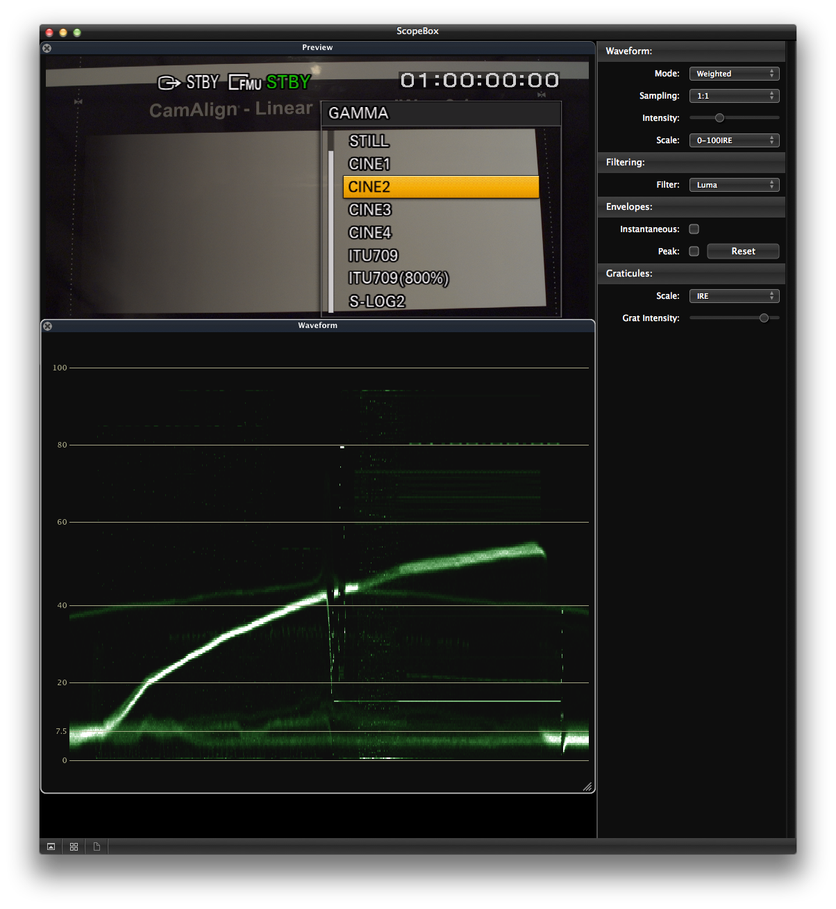

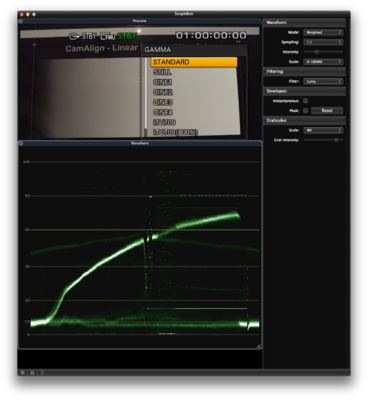

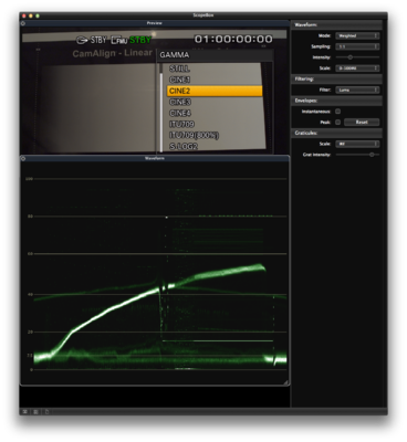

Gamma settings
I went through the Sony FS700 manual. The Picture Profile Gamma section explanation is a little vague to me. Can anyone better explain what each Cine accomplishes? I normally use Cine 1 for overcast lighting or bright skies Cine 3 for subjects with even illumination, Cine 4 for high contrast situation. For the most part I just eyeball it and pay attention to the histogram. I'm trying to be a little methodical about choosing the right Cine for a given subject.
-kAj
http://www.sweetproductionmedia.com/
Kajito Nagib is offline   Reply With Quote
Old August 5th, 2013, 09:43 PM   #7
Location: Toronto, ON, Canada
Posts: 3,637
Re: The NEX-FS700 Handbook

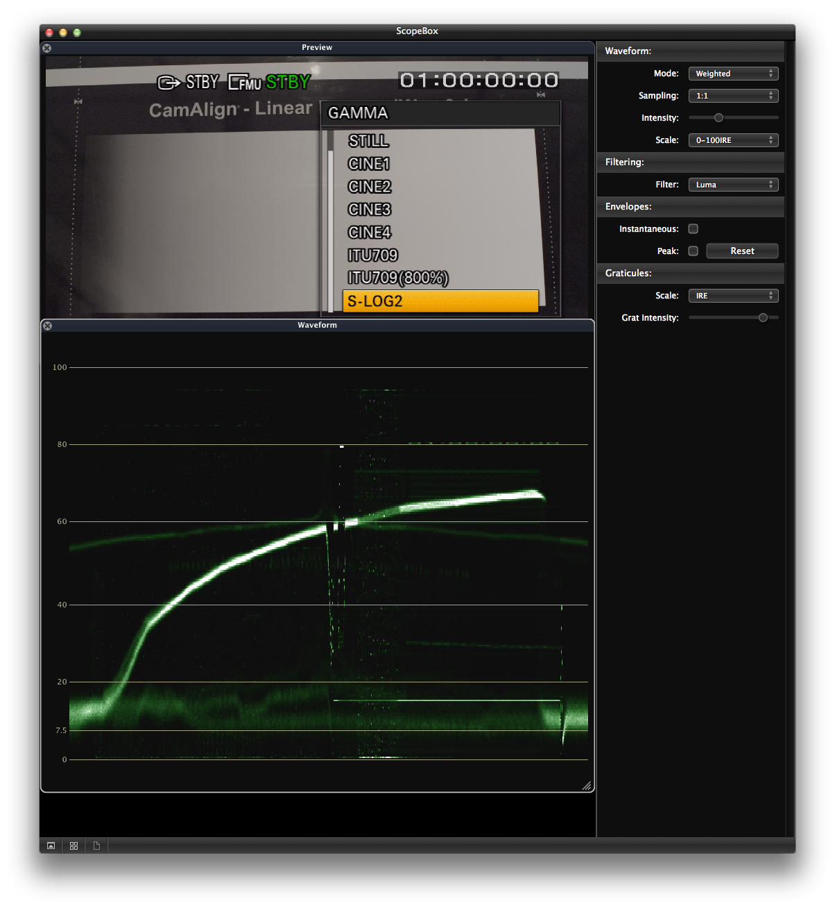

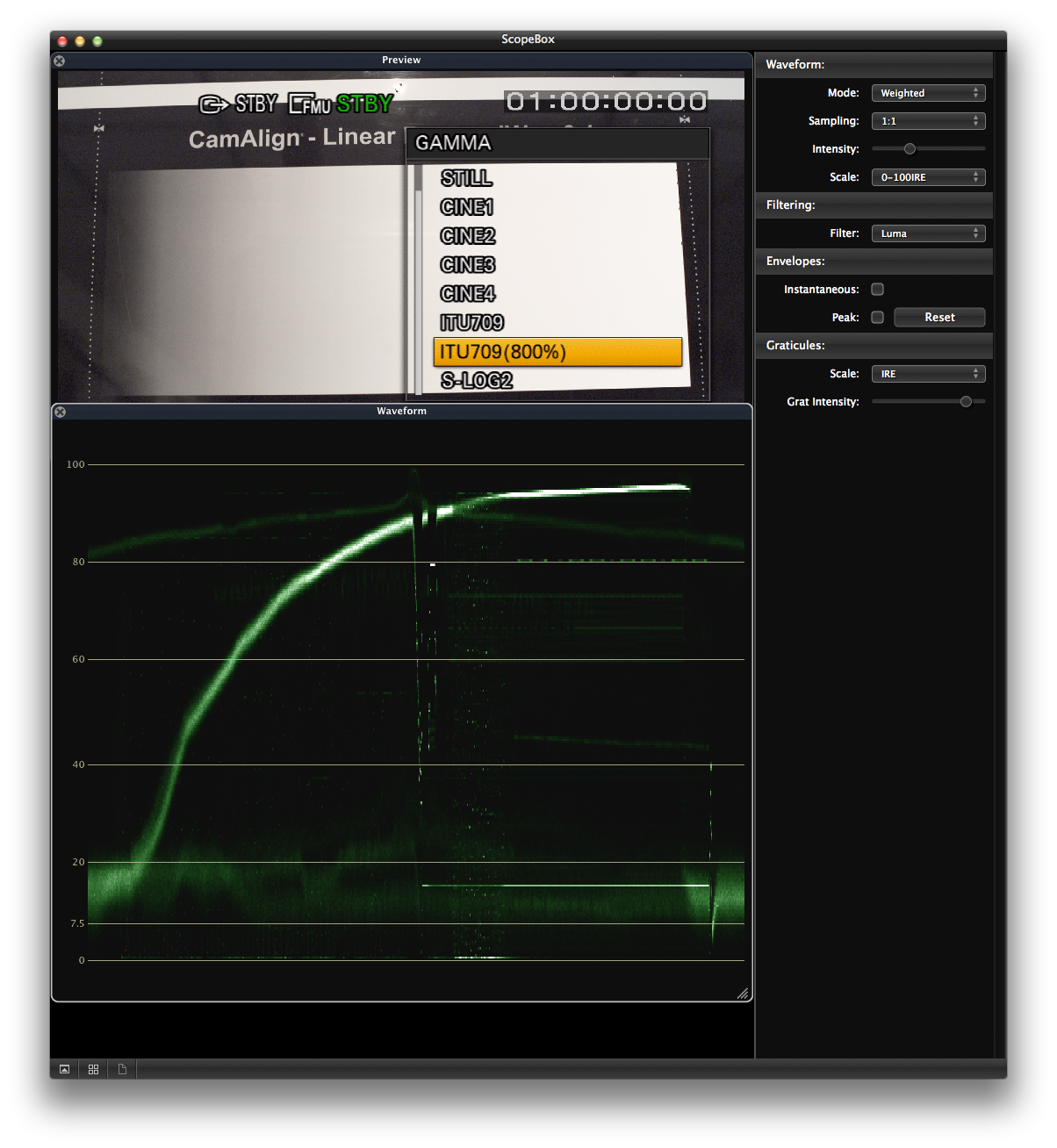

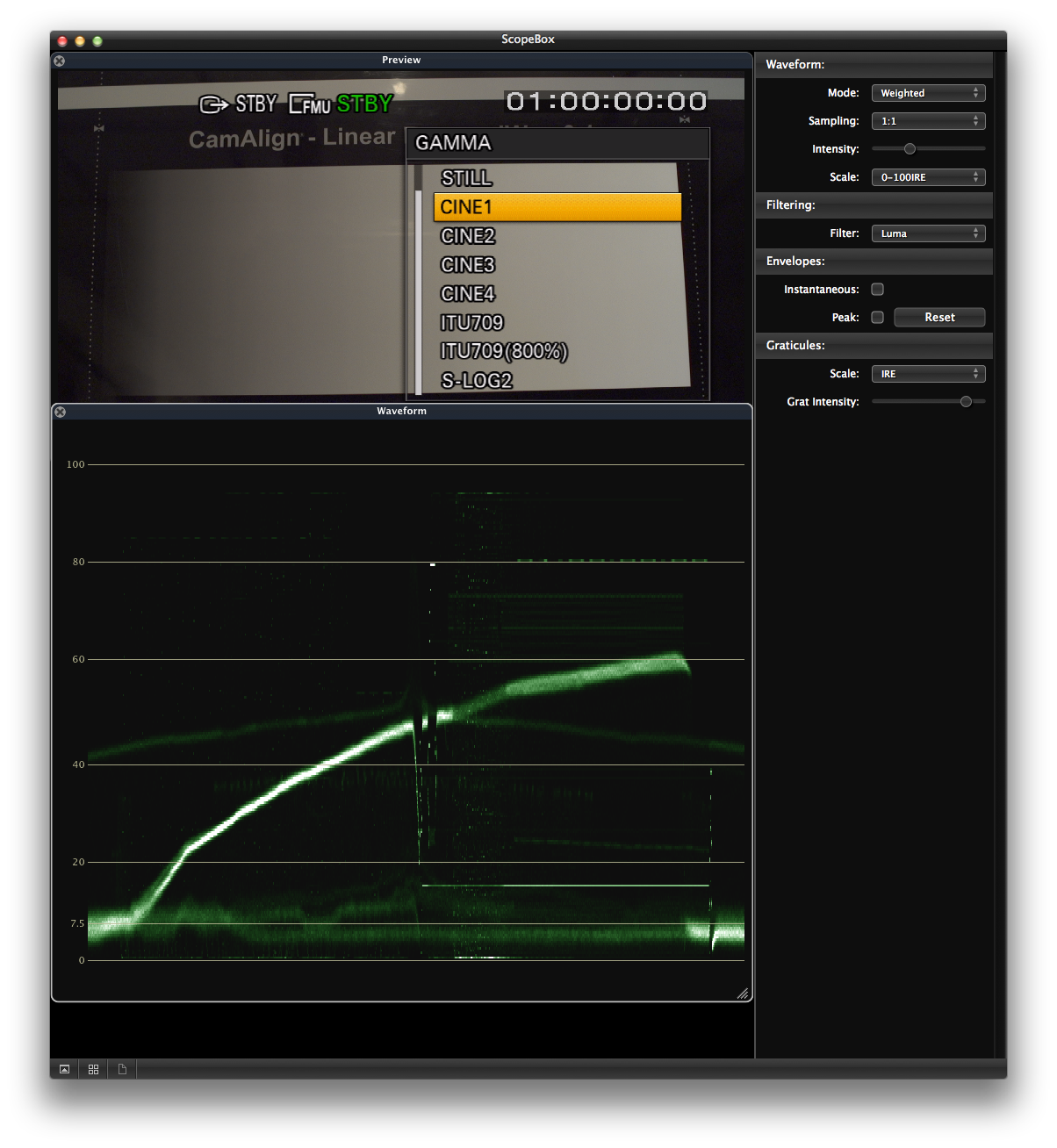

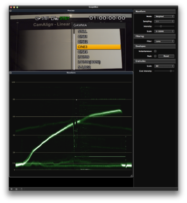

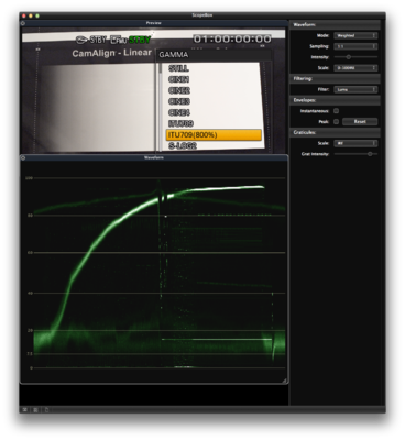

If it helps to understand the shapes of the different curves here are the different curves shot on a DSC Linear Ramp with knee and toe on factory defaults. "OFF" and "STANDARD" with defaults seem to be the same. This chart obviously can't give us a full 14 stops of reference, but it nicely demonstrates the strengths and weaknesses of the different curves.
I am building a backlit test chart that will allow testing of 14 or more stops.
The NEX-FS700 Handbook-screen-shot-2013-08-02-3.29.42-am.png   The NEX-FS700 Handbook-screen-shot-2013-08-02-3.29.32-am.png
