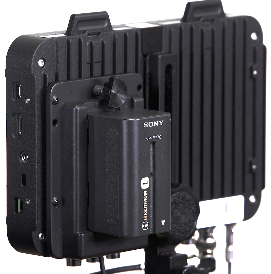

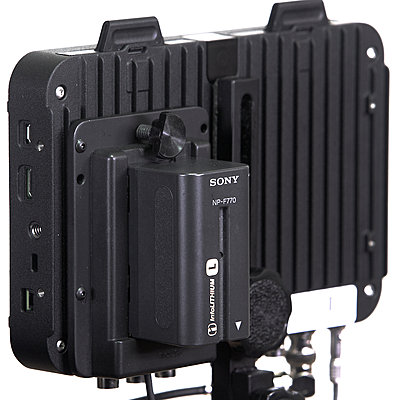

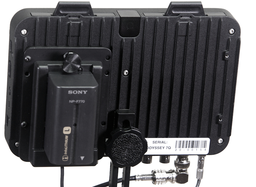

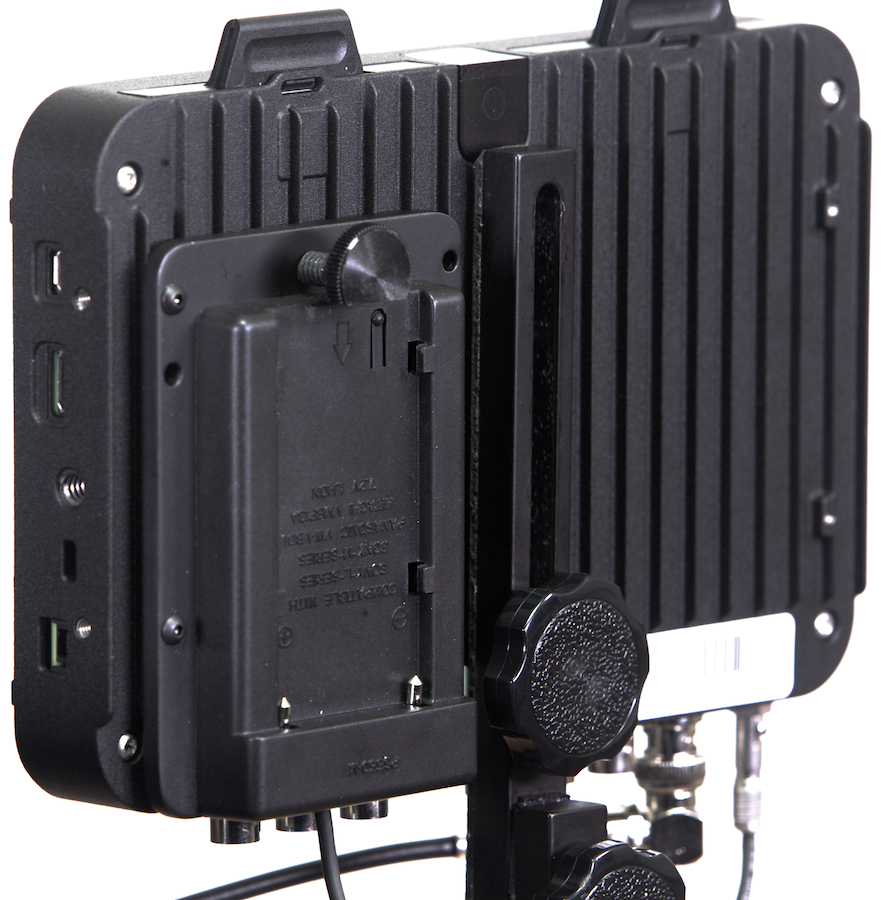

This battery bracket for the Odyssey 7Q works with the Sony or Swit batteries for the Sony FS700. It mounts on the back of the Odyssey on either the left or right side and is fully compatible with the West Side AV Odyssey Mounting Bracket. We make the cable the right length for the battery plate mounted as shown, longer cable lengths are available, email us when you order at info@westsideav.com for custom cable lengths. The battery is securely held in the bracket by an east to operate cam.
We also have IDX and AB solutions. But this is very light and compact, and a great way to use your smallest Sony batteries.
It can be ordered now here:
Odyssey Battery Mounting Bracket: Westside A V Studios WEB Store
We have brushed aluminum finish and black painted ones in stock now, and next week will have a batch of black anodized ones back from the anodizer.

What's with that thumb screw? Is it a fixing mechanism holding the battery plate to the monitor or is it a battery retention system (sounds a bit grand maybe!)

The "cam" thumb screw is a battery retention cam. It is optional but a very secure way to retain the battery. I have a different battery plate coming in a few weeks that does not need this "cam". Just a ¼ turn and your battery is very secure.

It's kind of disappointing that the battery plate is sort of bulky and doesn't really allow the battery to power the system in an integrated fashion but requires a dongle and connector. At that point, why bother with a battery on the monitor at all when one can use either a Swit S-8972 Sony style battery with a power output port so it powers both the camera and the monitor, or use a v-mount rail mounted battery.
I like the Ikan D7w system, as the battery locks in place with no tools, its low profile, and it auto-connects the power internally.
Of course, the D7w is no 7Q.

The only way to get power into the Odysseys without voiding the warranty is the proprietary plug. No tools are needed to mount the battery, it just plugs in, the cam screw is an extra precaution that can be used as an option. The plate is as small as is possible given the battery plate size for the Sony batts.
We also have IDX and AB battery solutions on the camera that run the O7Q and the FS700 as well as wireless receiver.
The Swit 8972 does not have the wattage rating to run both the FS700 and the O7Q, we were trying this at first, but it does not work.
There are times it is handy to have integrated power plate for the O7Q keeping the rig as small as possible. We have a C-stand (light stand) fitting and when used on a Cstand or table top, our bracket works as a table top stand as well, it is very convenient to have onboard power. And it is one less cable to disconnect when transporting.
