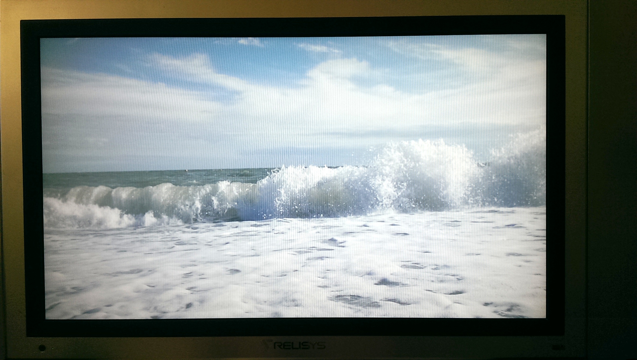

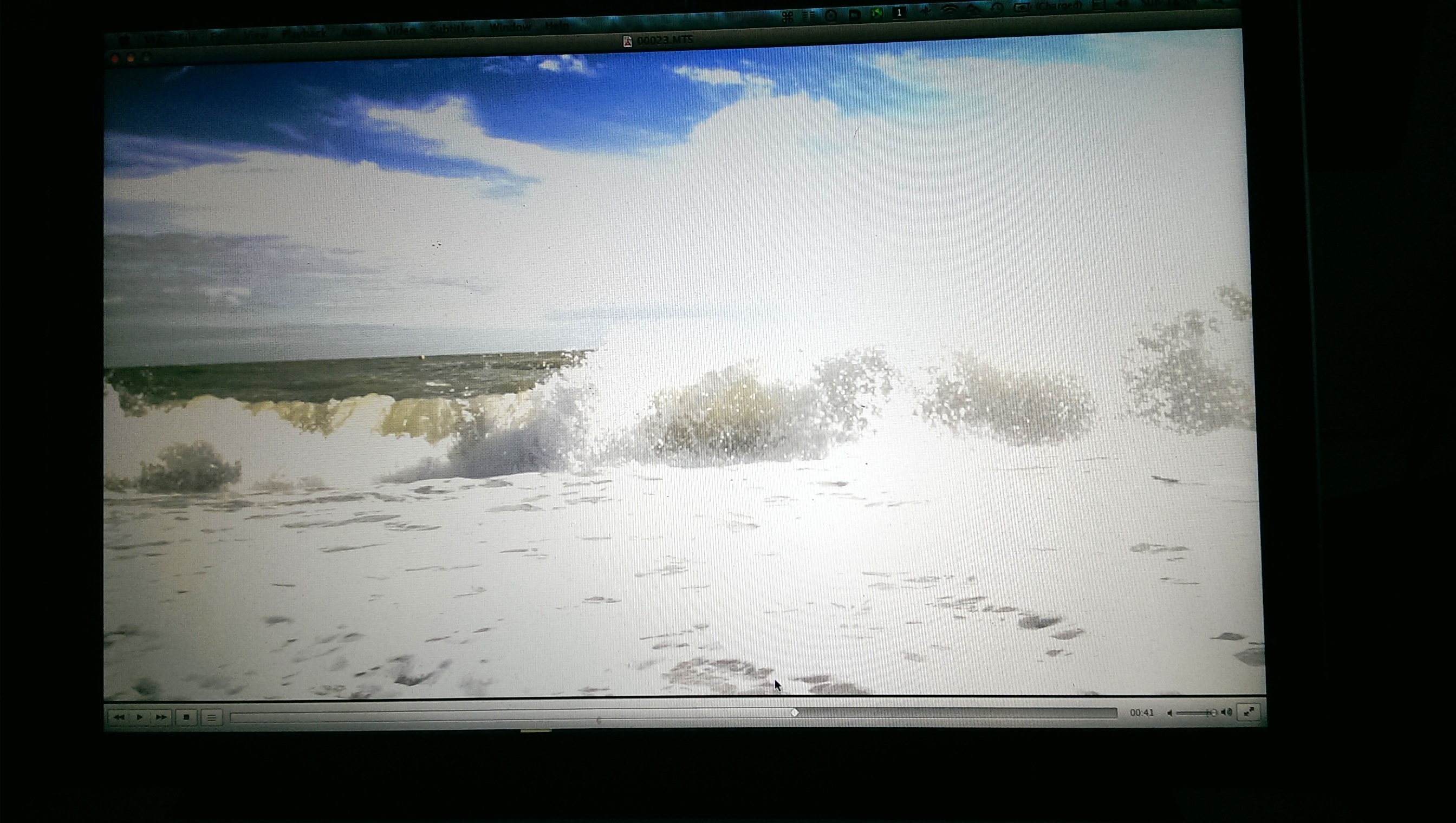

Hi,
I've only used this camera in super slow mo mode so I've no idea if this is a problem in other modes. I reckon it's a colour space issue so it probably is.
When I record stuff everything looks fine in the monitor, and all the highlights are just clipping in the histogram, but when I dump the material to my Mac and import into VLC or AE I get horrendously overexposed images.
Putting the card back in the camera, it looks fine on the monitor, and looks great on my TV via the HDMI.
What's going on? And what do I need to do to fix this? If this has been covered before then please point me to the appropriate thread.
Cheers! ;-)

Here's photos for a comparison. Actually there's more detail visible in the second, but it hasn't come out here. All lost when I import into any application....

Looks like AE is clipping those super whites (the 100-109 IRE range). From what I understand AE doesn't like footage with super whites, it wants everything in the 16-100 range.
