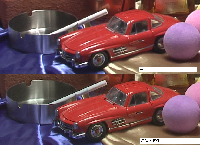

Pull up the 1080 30P samples for the EX1 and HVX200. look at the red car in the bottom left corner. I believe the EX1 is going to key well.
I'm amazed at how natural the image looks without the nasty artifacts that are seen in this image from the HVX200.

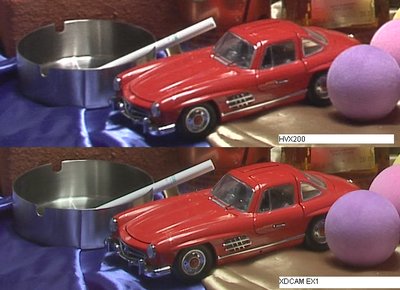

At least based on the 1080P stuff, it's obvious that a better key would come from the EX1.
Here's the red car comparison.
Again, I believe the HX200 holds up a lot better using 720P.
One on the best improvements needed for the HVX200 would be in noise levels.
If the HVX200 had improved noise, the 4:2:2 images would look a lot better, although
would still be soft would directly compared to the EX1.

The picture with the red car is so damn sharp it looks like if there was peaking on it :)
One good thing with a real native HD format is the precision you'll have when keying. But due to the 4:2:0 sampling, you may have to tweek the settings a lot more to go through the subsampling problem.

Wow the picture with the red car is stunning. Please God let me save some money for the EX1!
