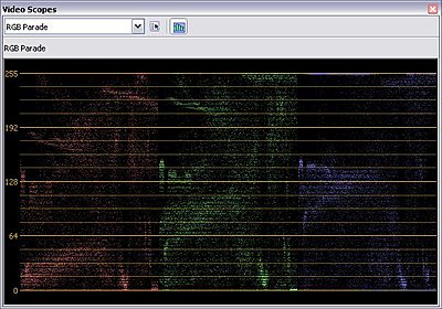

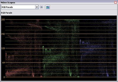

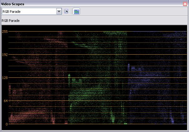

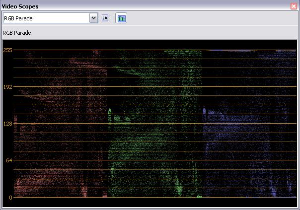

I have shifted the STD1 knee 95 slightly towards red in Vegas, to get rid of the bluish tint in shadows. It's better now, I think.
The conclusion is: each preset needs its individual colour balancing!
abrupt highlights clipping-std1-knee95-rgb-parade.jpg   abrupt highlights clipping-std1-knee95-cced-rgb-parade.jpg
abrupt highlights clipping-std1-knee95.jpg   abrupt highlights clipping-std1-knee95-cced.jpg
