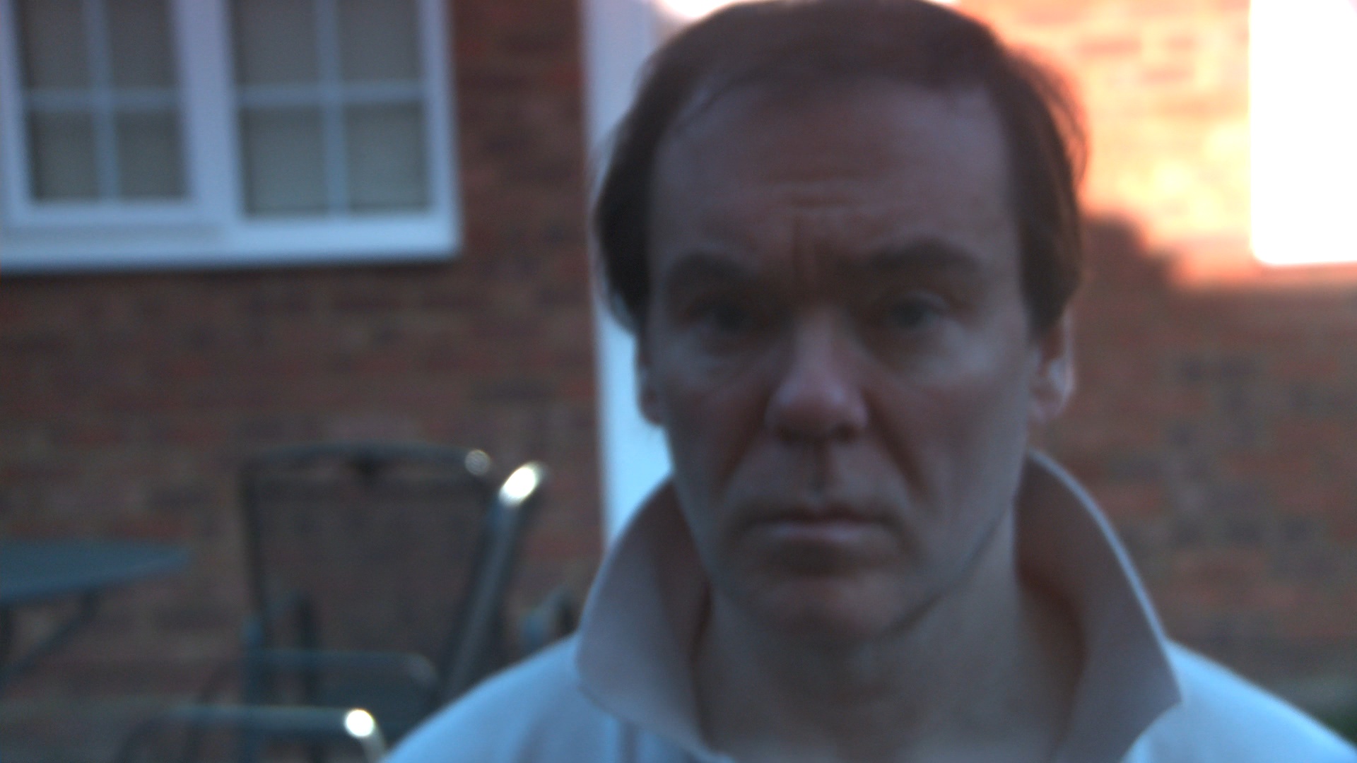

Piotr. I got a nice red Halo from a part overexposed image I was testing. I don't know if this is any use.
Mark, I don't think this is the same problem we've been discussed here; it looks to me more like the light spilling through the guys hair... But can't be sure.

Well the guy (Me) is quite a way into the shade. Sunlight is hitting the wall behind so you have an area (Me) That is underexposed and an area behind that is over exposed. The fringing around the hair shouldnt happen because Im not near the sunlight. The sunlight is behind and the halo is not through the hair its around it. Also following the brickwork too. It cant be light spill because this was an area of shade but also the halo follows the brickwork in the overexposed part.
