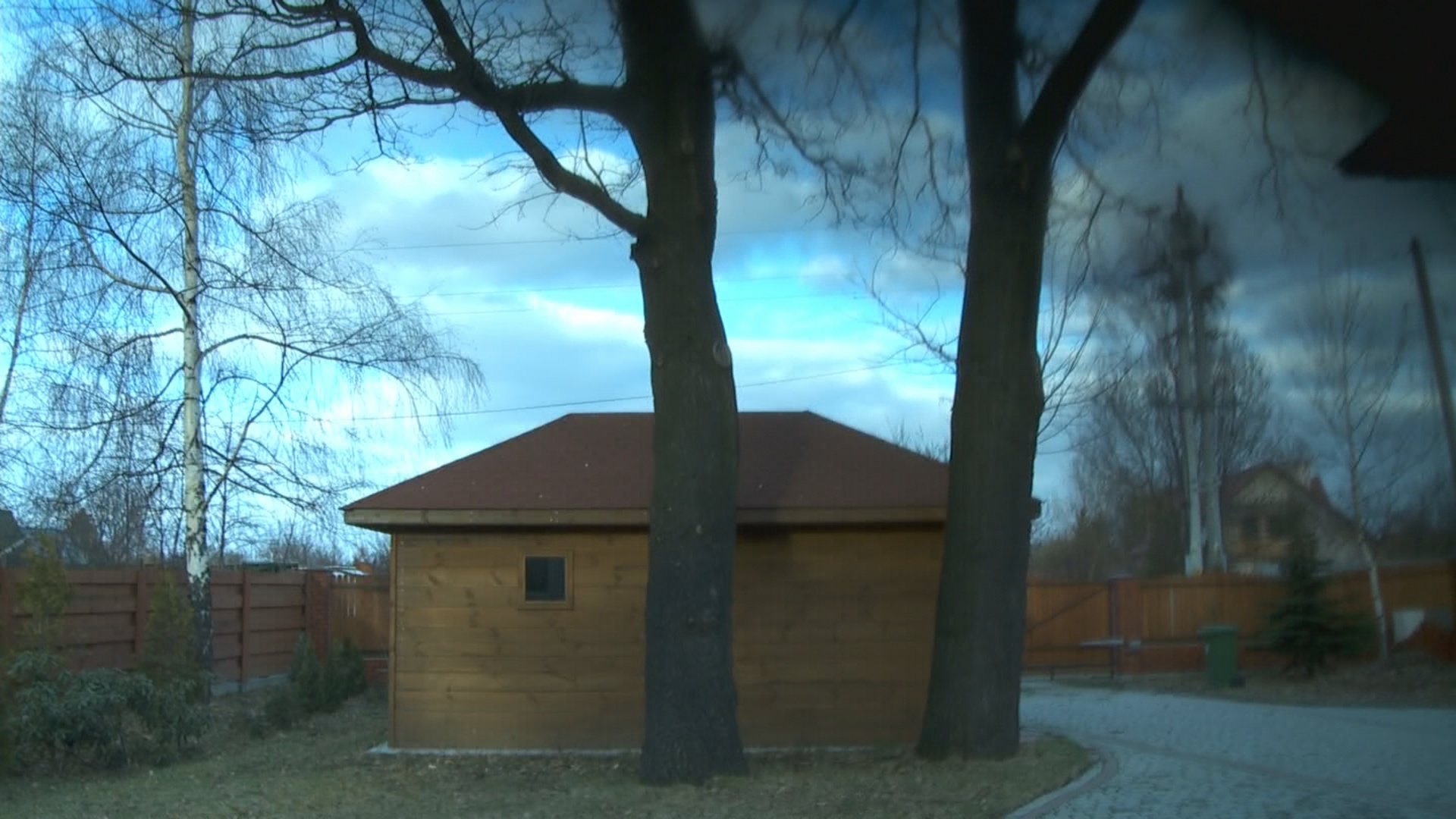

The trees are acting as nets or scrims in the "problem" images. They are dropping the exposure of the sky... and hence your results.
As you zoom in, or even better walk closer, to the branches this should "magically" go away. This is because eventually the branches are too far apart to operate effectively as a scrim/net.
You will observe the same effect on diffuse lights, and especially lights with nets or scrims on them.
You will observe this with any camera. The exact circumstances will vary a bit based mostly on the sensor resolution, lens resolution and to some degree on the exposure. The main point is that regardless of what camera you are using you will find some combination of fine elements that will trigger this perception- that includes your eyes.
That is just the way light works.
All the talk of gamma levels and matrices is off the mark. No really - all of it. Go shoot that same scene with an HVX200, RED, a Viper or 35mm and you'll get similar results. (Again accounting for the sensor and lens resolution.) That isn't to say anyone's been wrong- just wrong that it has anything to do with the "problem."
The one note is that the issue is made more prominent by the XDCAM codec. Capture that as ProRes and while you'll still see the problem, but it will be less objectionable.
The case presented here can be "solved" in one of two ways:
1) drop exposure so that the entire sky has a valid exposure level. The differences in exposure in the sky will thus be less objectionable.
2) increase exposure levels so the sky well and truly blows out, then do a sky replacement in post.
3) use a filter or grip kit to bring levels down in the sky. I'd try a graduated ND filter first.
A circular polarizer might help a great deal. It would bring exposures down a bit and may have some effect on the fringing.
If it was a film set with a still camera I'd drop a net very close to the lens (and out of focus) to bring the level down in the sky. The net will also give that portion of the image a little softening. The problem with nets is that the edges are sometimes too thick.
For a lot of ENG/EFP video work I'd just live with it during acquisition and maybe throw a vignette and a soft blur on the image to drop the levels and sharpness there a bit. That would soften the effect a bit. There is no post solution that will really fix that sort of thing though once you shoot it.

OK guys - you got me convinced that this is not actually a flaw, but a feature. I did some backlit shooting today with all the factory setting, but the Knee point of the STD3 curve dialed down from 90 to 75.
The result is that I can no expose the darker foreground much better before they sky even starts to overblow (which was expected). However, once it does, the trees act exactly the same i.e. before the exposure is too high (and whole sky is simply white), it goes though the same stage where the sky areas right behind the trees become blue-gray (ugly and unnatural, as the rest of the sky is already white).
Now, my question is this: apart from changing the knee point, should I also change the slope and/or sauration in order to minimize this effect? Please give me some theory background to this; let me stress that I'm no longer looking for "flaws", but investigating "features" :)

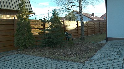

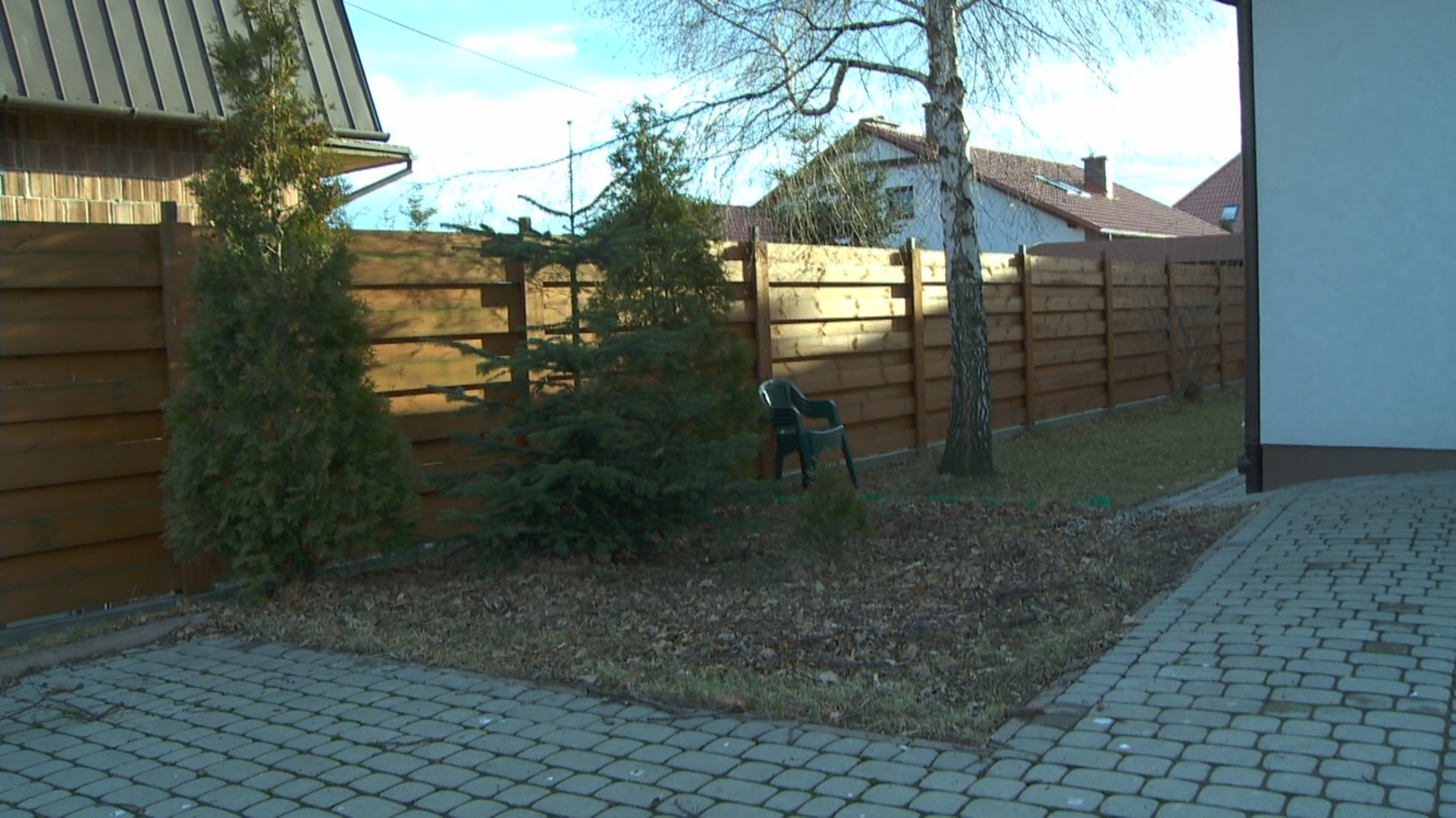

This is becoming funny... I know you guys don't regard me high as a camea operator, but I have just finished my next couple of tests, and have a couple more surprizes for you:
1. Even with cine curves, at the moment EX1 starts clipping (and you cannot totally avoid it), the resulting colour patches are awful to watch (see the left grab: as if the blue colour resosution was insufficient). In the right grab, I was those tiny fractions of a stop on the safe side, and the sky exposed better.
2. I'm not sure, but I guess I have found the vignetting problem source; do you recognize the upper right corner thingy in the right grab? - well, it is the ND filter not quite snapped in...What a silly construction, and why no knob to rotate it quick and precisely?
Anyway, even though I really appreciate your experience and knowledge, I can now state it with 100% certainty: the highs compression algorhitm on the EX1 is faulty. You're simply wrong saying that all cameras do that; my V1E doesn't do that - period.
