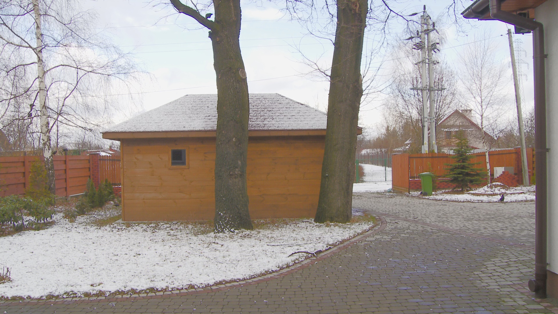

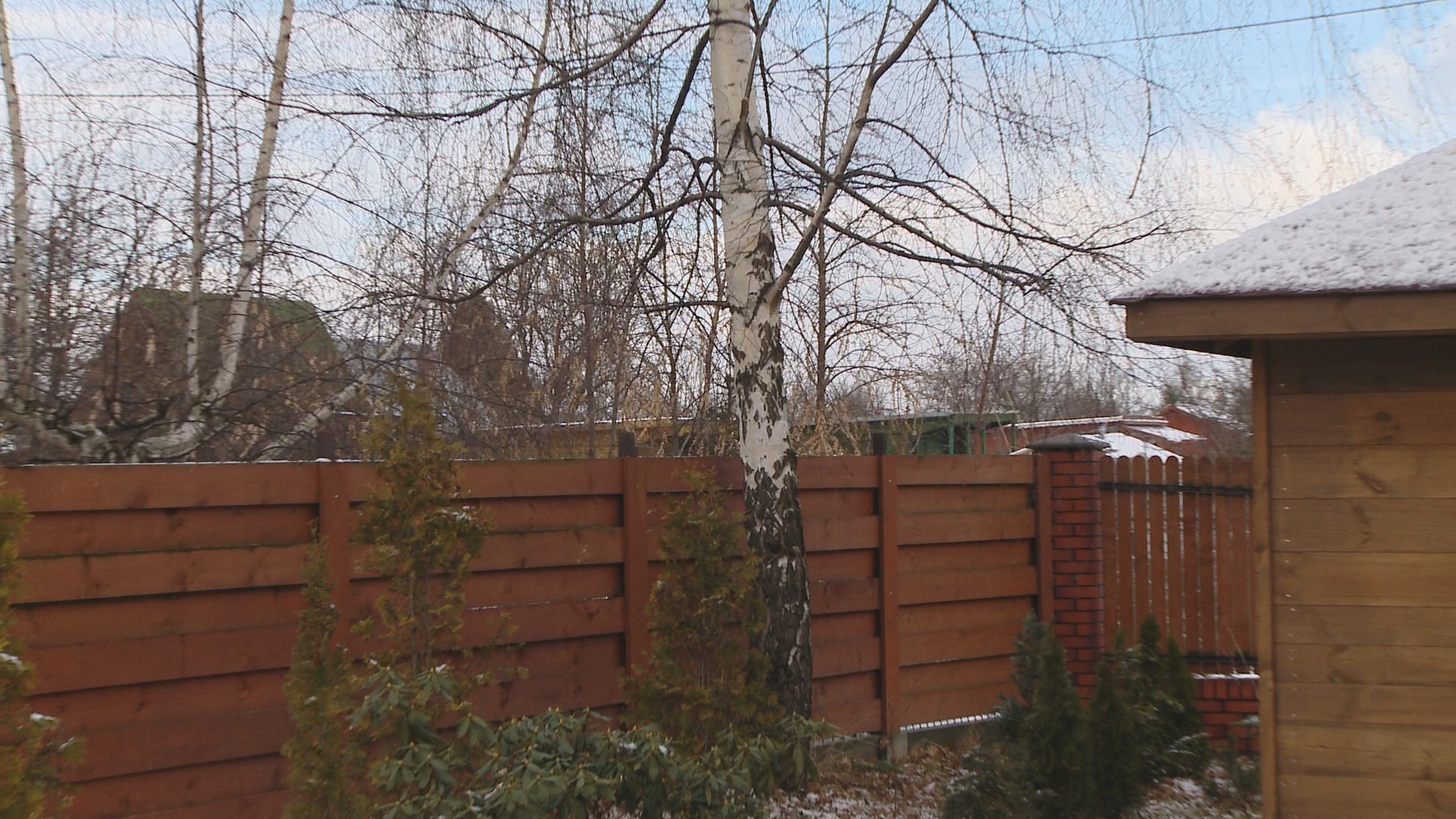

Bob, Bill at all,
I knew my gut feelings were not deceiving me. Have just browsed through the very first recordings made with the EX1 on day one (right of-the-box); unfortunately don't remember what settings exactly I was using (it might be cine gamma, but almost most certainly not Hisat matrix). Anyway, the sky behind foliages is treated correctly; it beats me why anybody should think the ugliness I showed before was a normal thing!
As soon as we have more sun here, I'm going to try and re-create. If it's the Hisat matrix at fault, it probably is badly programmed or for special purposes only (like lowlight/ indoors - without highlights, anyway). If I can't reproduce the clean look below, at least I'll know the camera needs servicing, after all...Or does it have any factory reset switch / key combination?

I knew my gut feelings were not deceiveing me. Have just browsed through the very first recordings made with the EX1 on day one (right of-the-box); unfortunately don't remember what settings exactly I was using ...
Piotr, trust me- you are seeing mostly a normal photographic effect. It was made more obvious (and a bit ugly as you say) by incorrect exposure. The codec had some effect, but you would have seen it in 35mm too.
I know you are seeing different things now than with the earlier shots, but there are lots of factors, including the lighting, that have changed.
Take your light meter out there. Take an incident reading at the camera, then take some spot readings at the trees, the sky behind the branches and then at the unobstructed sky. I suppose you may want to take readings at the fence- look just go crazy and meter everything.
(Don't forget to calibrate the light meter and the camera together!)
Take a few bracketed exposures for a few subjects, writing down all your settings... not just the picture profile but the aperture, zoom and focus settings- and your meter readings too. Then go back in and evaluate the images with that information at hand.
If you have a DSLR or 35mm camera go out there with that and do the same thing. Heck, try it with another video camera too.
Let me know if you still think you have a problem when you are done with all that.

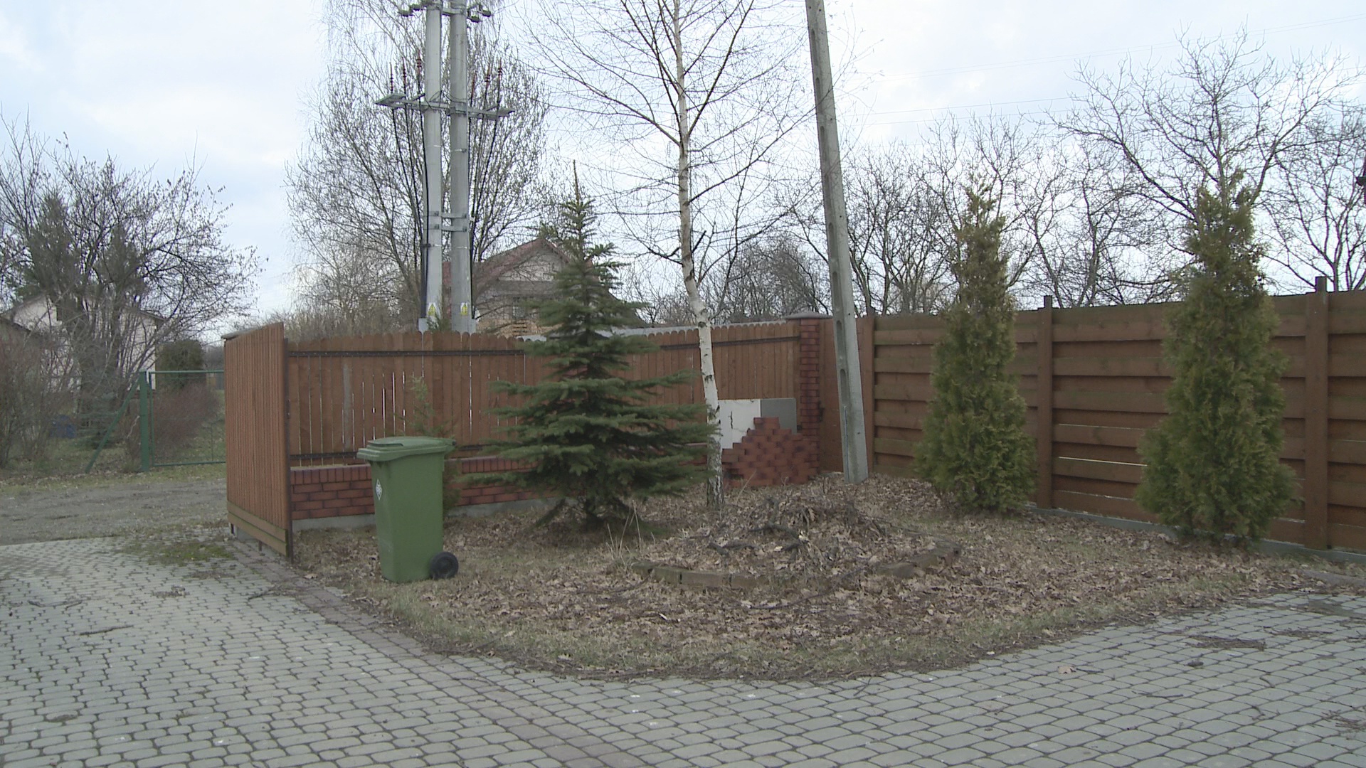

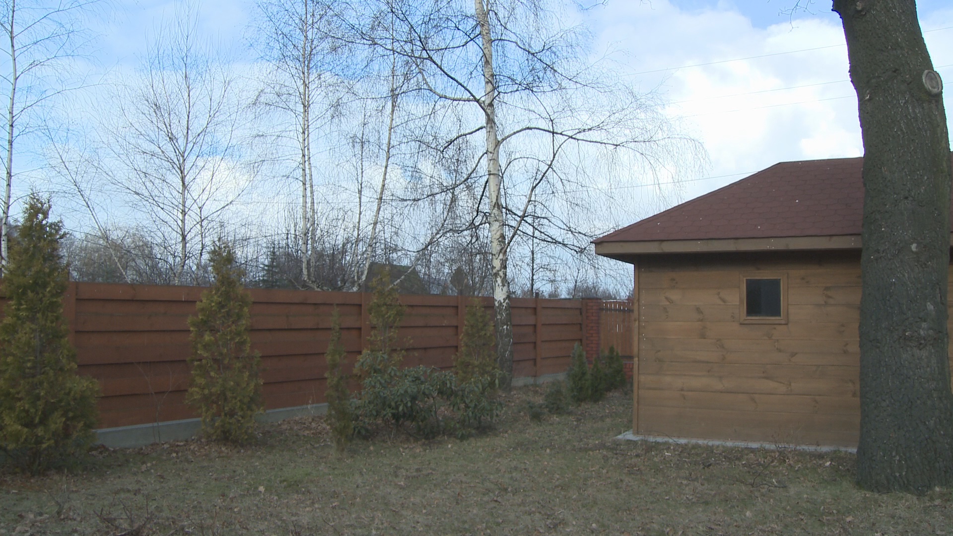

OK, so I reset my EX1, and shot the same scenes (sorry they are boring) with many different settings, but steering away from the Hisat matrix. The two grabs below are just the factory settings. The scopes in Vegas still reach above 100, but the artefacting is mostly gone - just the tree branches against the sky!
I guess two important conclusions (not scientific at all) may be drawn:
1. The Hisat matrix may be good for making dull scenere more punchy (like low light, indor scenes), but not where white cliping may occure
2. While other cameras (well, at least the V1, HC1, Canon A1) tend to spill the backlight into and over contrasty details (making the twiggies even thinner), on the EX1 we can see something quite opposite: the dark objects against highlighted backgroud tend to "overshadow" it, resulting in retaining the original colour of the backgroud which otherwise would already bee blown to white.
Please note that I didn't have to drastically reduce exposure, and the foreground objects are bright enough and NOT oversaturated, like they had to be with the Hisat matrix if I wanted to prevent the trees-against-sky artefacting.
PS. The more I work with the EX1, the more I hate the ND filter switch! Unfortunately, this is not going to be improved with a firmare update:(

Looking at Image83, the whitest cloud above the end of the top of the roof is clipped and has lost detail. It's not visually objectionable because clouds can be all white (no pun intended) but if that was a patch of blue sky you'd be likely back to your original problem.
Which I think goes back to something I said many pages previously. Clipped specular highlights are generally visually acceptable because they're almost invariably white anyway. Your clipped cloud is another example of where only those who go looking notice. It's predictable and visually acceptable. Your previous problem with the sky is predictable but visually unacceptable.
I posted a link to an article on Luminous Lanscapes about histograms and what they mean and how to use them. The author made a very applicable point. A histogram inside a view of the scene is very useful, you need to look at the scene AND the histogram to guage what is going to be the result.
For certain, Hi Sat could bring you undone. If not, a logical question would follow. Why make it selectable. If it's always such a desirable thing why not just have it like that on every camera. Again a good point from the Luminous Landscapes article about a very similar scene to yours. We're trying to fit a scene with 11 stops dynamic range into a medium with 5 stops and it will not fit (well it wouldn't on his DSC or film camera). All the image adjustments these Cinealta cameras have gives us a better shot at squashing it in but it's a risky business. Some of the possible adjustments are as you've noted designed for different kinds of scenes or use under controlled lighting. Many of them are features from high end cameras and many users here and elsewhere have for years be asking why Sony make us pay large sums of money to get a camera with them. Well Sony have delivered but it is a case of buyer be aware.

Bob, Bill, Leonard at all,
Thank you very much for your input. I don't need to tell you how much relief the output of all that is to me; I was really very frustrated over the last two days!
I feel flattered by the fact that again, my observations coincide with (by far the most comprehensive so far) EX1 review from Adam Wilt; the statement that Bill has quoted:
"I’ve found that the EX1’s knee does a fine job except when highlights are strongly colored. Saturated highlights show more hue shift and harsh clipping than I’d like. I’m exploring this further out of curiosity, but even if the knees were perfect I would still shoot with cine gammas, because I prefer the progressive compression to the look of a traditional knee."
- has been practically illustrated in this thread, I hope. Note the terms "hue shift and harsh clipping"; add the Hisat matrix and you will get frost on bare trees! Or patches in the sky that almost look like ink stains.
Also, I couldn't put it better myself, Bob - your statement:
"Clipped specular highlights are generally visually acceptable because they're almost invariably white anyway. Your clipped cloud is another example of where only those who go looking notice. It's predictable and visually acceptable. Your previous problem with the sky is predictable but visually unacceptable."
- may well be considered the final conclussion of this thread.
