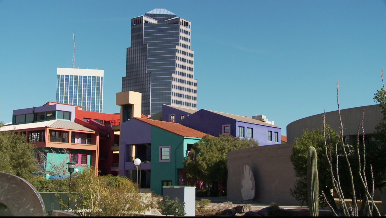

he was not using the cine gamma curves which roll into the highlights. He was using the std3 setting.
I've got plenty of sky images holding up decent latitude.
Here's an EX1 frame grab. It was shot about 11:00 AM.
I believe it was Cine3

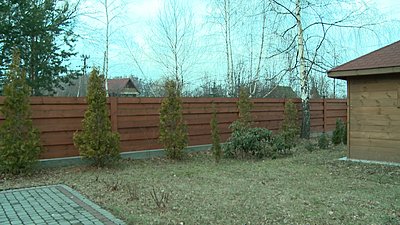

While I fully agree this behaviour is unacceptable, I'm slowly coming to terms with it. You see, we're trying here to squeeze maximum quality from a standard (i.e. non-cine) gamma curve, which has been used in conjuction with considerable colour saturation increase (with both Hisat matrix adoption and several primary pairs adjustmenst), but WITHOUT even trying to optimize the curve's KNEE settings...
As I said before - if you want to get saturated and rich colour, either use cinegamma (e.g. CINE1) which takes care of the proper KNEE setting itself, or adjust the KNEE with a standard gamma (like the STD3 used in this case).
Otherwise, don't expect good results with backlit scenery, cause you will either end up with this ugly patches I have shown, or you will severely overblow the backgroud, or you will get nice and rich blue sky but severely underexposed and over-saturated foreground.

Leonard, you say you've never saw such behaviour with your 20 years with cameras that didn't even have cine gammas; perhaps this is the clue? Now that the cine gammas are available, the standard curves are more "relaxed" and left to the (knowledgeable) users to shape. My experience is much less than 20 years, but I must admit on the V1 I never pushed the standard gamma so hard!
Anyway, this really isn't nice - that's for sure. This grab has not been exaggerated by the 32bit Vegas stretching; it's exactly how it looks at playback time on my monitor (and it's really difficult to rate it as "severely overexposed", either - as Bill is suggesting):
