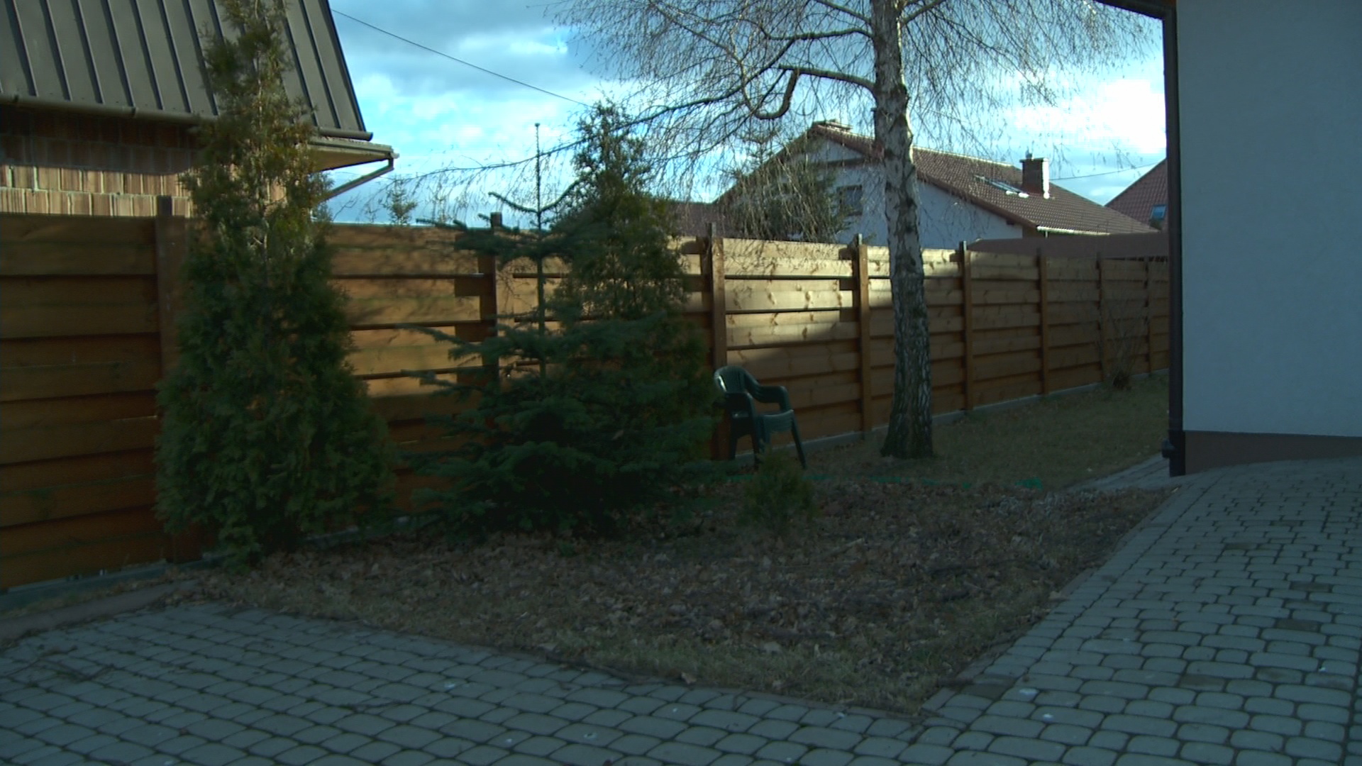

Sure, the problem is that you have no real benefit of this latitude: here is the grab perhaps some half-a-stop less exposed that image54 in my previous post; this is how the sky really looked (well, almost: there still is a single, unnatural patch of light blue there). Why no gradation between the blue tones, but the abrupt change in colour? This simply shouldn't happen - nobody will tell me one of these two grabs is poorly exposed (if anything, perhaps slightly off-focus, as it was a walking shot). And when you watch those changes in the actual video, it looks even worse because the patches appear and disappear constantly all over the sky.

Yes, it's all with Hisat matrix. But the Standard one looks muddy - and again: on the V1E, when I choose Cine1 gamma and Cinecolour on, I have everything at least as saturated as with the Hisat on the EX1, but still no patches when slightly overexposed.
I'm going to give the Cine matrix with one of Cine gammas the last try tomorrow.

Are you believing that the closely paced branches in the sky view do not reduce some of the sensor illumination at those given points?
I believe Alexander and a couple others have mentioned this. I'm not sure why you think it should not. Also, since I'm away from the office, I did not bring the image in and analyze it, but the sky sure looks over exposed in some locations. I know you doing the over exposure on purpose, but I'm not sure where this is going....

Exactly Thomas - I am over and under exposing on purpose, to learn the new camera limitations and discover its strengths. Where is it going? Well, I thought I said many times: I'm trying to find a way to avoid abrupt colour changes (nasty patches) where the camera is just on the verge of, or slightly crossing, the clipping boundary. So far I haven't succeeded; I agree that tree foliages are enough to limit the amount of light just like some sort of ND filtering, but the resulting patches are washed out of any colour gradation, as if the colour resolution was insufficient (I'd call it near-clipping banding). The V1 doesn't exhibit this, so please don't tell me it's normal.

Nobody even commented on the vignetting caused by the ND filter - could it be something quite separate from the infamous vignetting problem?
