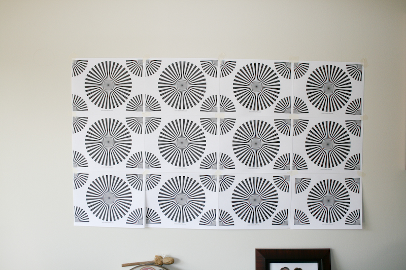

I used this test chart setup yesterday to do the flange back routine. Positioned the camera 10 feet away from the wall, zoomed in 14x and then let 'r rip. The result was an improvement for ND Clear setting. ND1 and 2 are better but not as good as I'd like to see. The camera is still going to Sony next week to fix other issues but I'll still get them to look at the back focus thing at the same time.
Serial# 0100569
FW - v.1.02_0337
Camera showed up in the middle of December.
- Don

Don,which order did you perform the test,ie did you do ND off then ND1 then ND 2 ? Because if you did then ND 2 should've been the best IF the cam only remembers the last adjustment !!
Can you post some screen grabs ?
Paul.

I will later. But I don't have any before pics. Just after the fact. I started the routine using ND2 and worked my way back to ND Clear.
- Don
