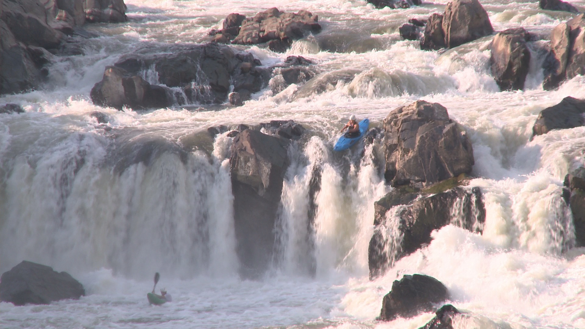

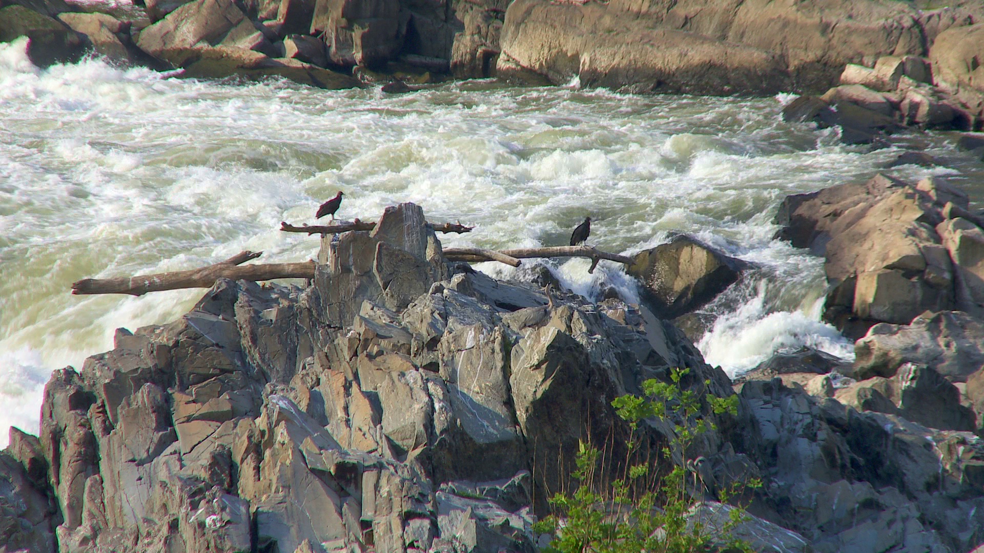

I'm having some problems with this too after doing some test shots with my new EX1. The right side is definitely out of focus compared to what is in focus on the same plane.
I have attached photos of two good examples.
Is this something I should send into Sony or should I try to do the auto back focus maintenance? From what I have read so far, it seems like sending this into Sony seems like a crap shoot if it will be fixed - or am I just running into the wrong feedback?
This is a bit discouraging, especially with the zoom on the EX1 being only at 14x and how much Sony was touting how good the lens is, maybe I should buy an EX3 instead with a proper telephoto?
