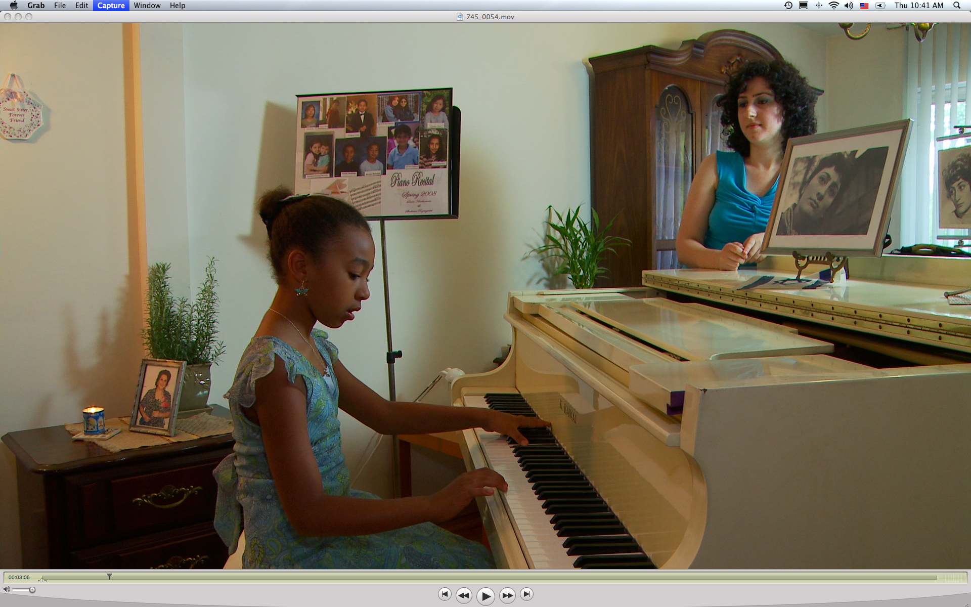

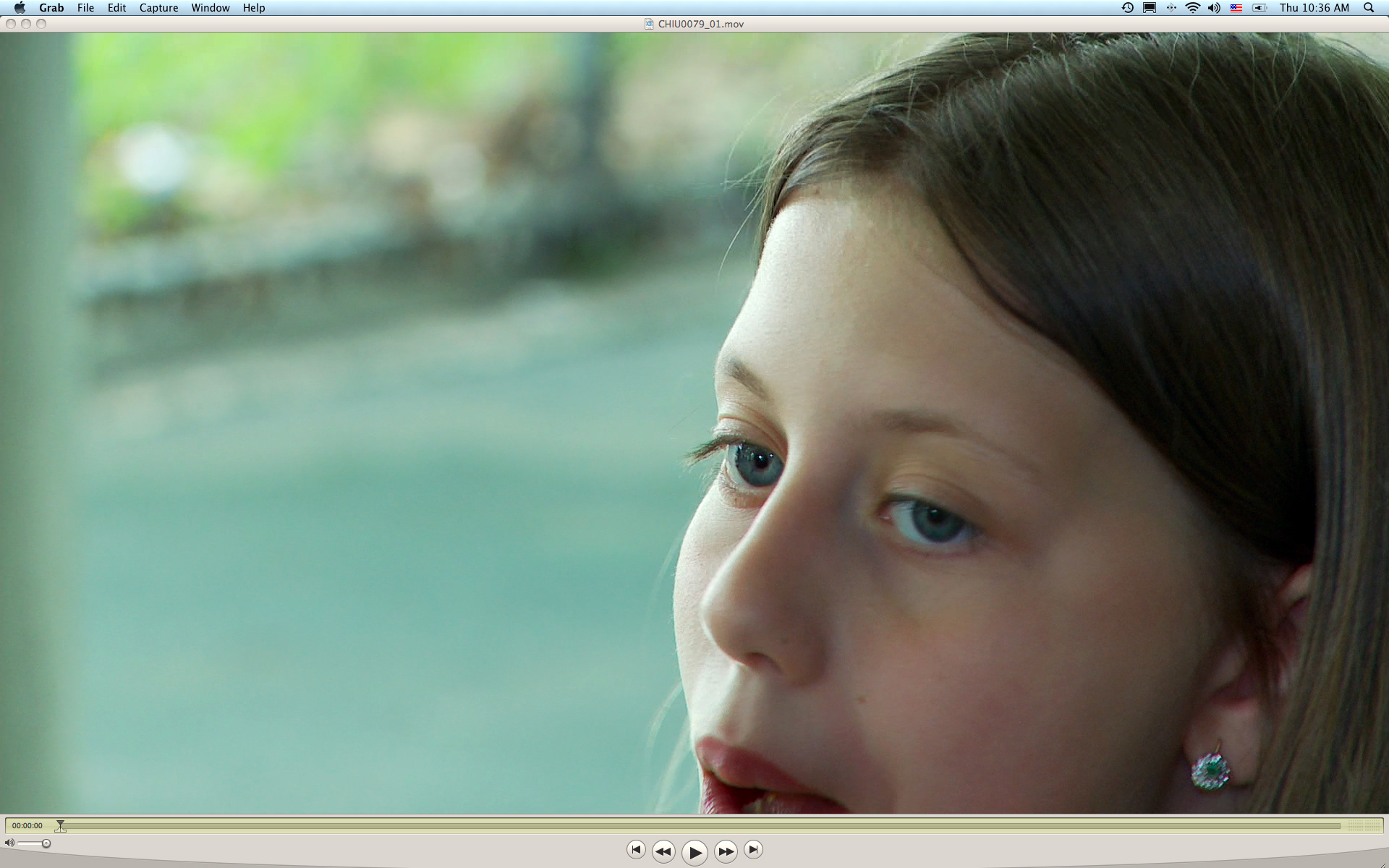

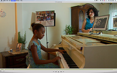

as of which filter, jonathan, i was down this road last month as i did not want a filter on mine either.
so i bought 3 of the more expensive schott glass filters available, mounted each on a sturdy tripod and did some indoor and outdoor testing. spent some hours testing it and decided to stay with this one.
http://www.bhphotovideo.com/c/produc..._Haze_010.html
mostly because of the slimness of this model. solid brass ring and thinner than even the thinnest pro hoya mount. the visible difference between this model and the clear scheider model even at 200% under photoshop was minor. for samples both outdoors and indoors.
i grabbed some un-edited videos i took recently for you to examine.
one was with side light and normal to short telephoto
one was with the sun in the back and to the side
one was indoors
1st 2 grabs using quicktime and mac os' "grab" function
last boy grab using vlc screen capture, a much smaller file.
handheld with steadyshot on.
all 3 with the slim b+w uv i noted above.
paul
