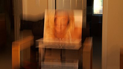

The EX1 is about three weeks old. While looking at each of the gamma profiles with a DSC labs chart and a waveform monitor my EX1 started making a mild buzzing noise.
I noticed vibration when I touched the mic/control panel module. The picture is now badly blurred vertically and moving up and down in a random pattern.
The EX1 is mounted on a Sachtler 20 tripod, locked down on the charts. No error messages, no blinking tally light, no buzzer.
Image stabilization is OFF, I have tried changing zoom, focus, macro, i/p settings, camera OFF - restart, Reset All - no change.
Help!

sounds like a failure in the IS system

My thought too, but the IS is turned OFF. Software switch may have also failed I suppose.

This problem is constant and the picture bluring is severe. The JPEG is a still from a short clip recorded while the camera was on a locked Sachtler 20 tripod.
