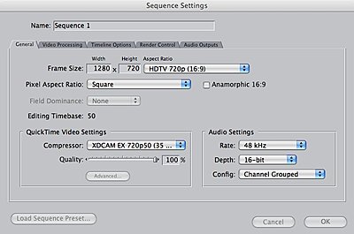

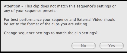

Or Drop 720p50 clip on new sequence of any kind and if it the clip doesn't match the sequenced settings you'll get this popup. Select Yes.
If you need to put the foot on the gas peddle you don't need to do deep sea oil drilling.

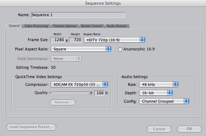

Follow my previous instructions and you do not need to enter this by hand but here's the settings.

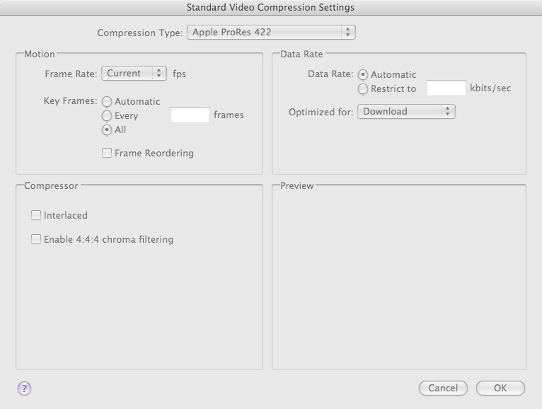

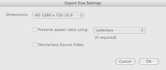

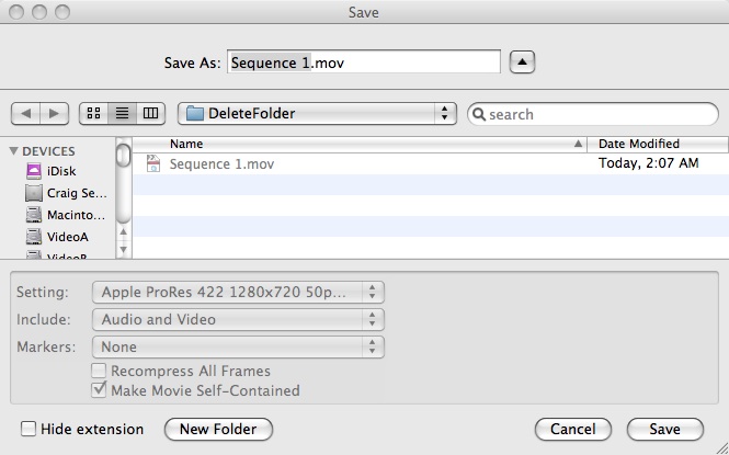

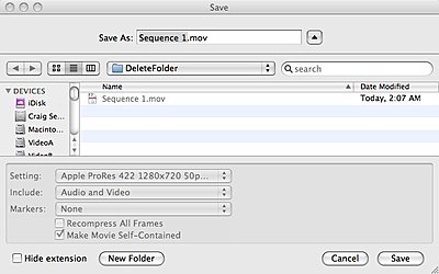

See AppleProRes1
Export/Quicktime Movie. Change Compression type to AppleProRes1280x720 50p
or
See AppleProRes2
Export/Quicktime Conversion
and then see AppleProRes3
Set Dimensions to HD 1280x720
How to do this is "newbie FCP 101" so I take it you've never used FCP before.
XDCAM clips from a MAC to a PC-appleprores1.jpg   XDCAM clips from a MAC to a PC-appleprores2.jpg
