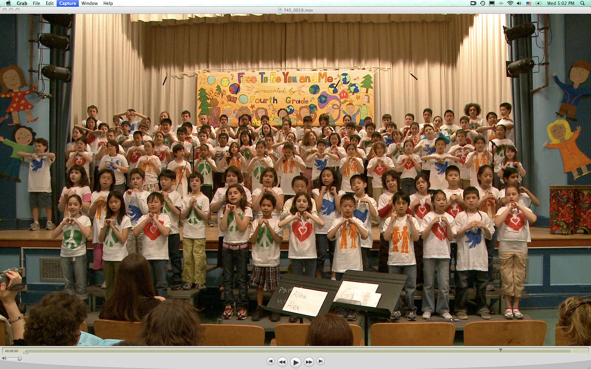

just saw the skin tone detail on page 74.
ah, i wonder if it will do enything for large groups like in my first shoot.
Originally Posted by Michael Maier View Post
Nice samples Paul.
I guess nobody around here uses the skin tone detail feature?

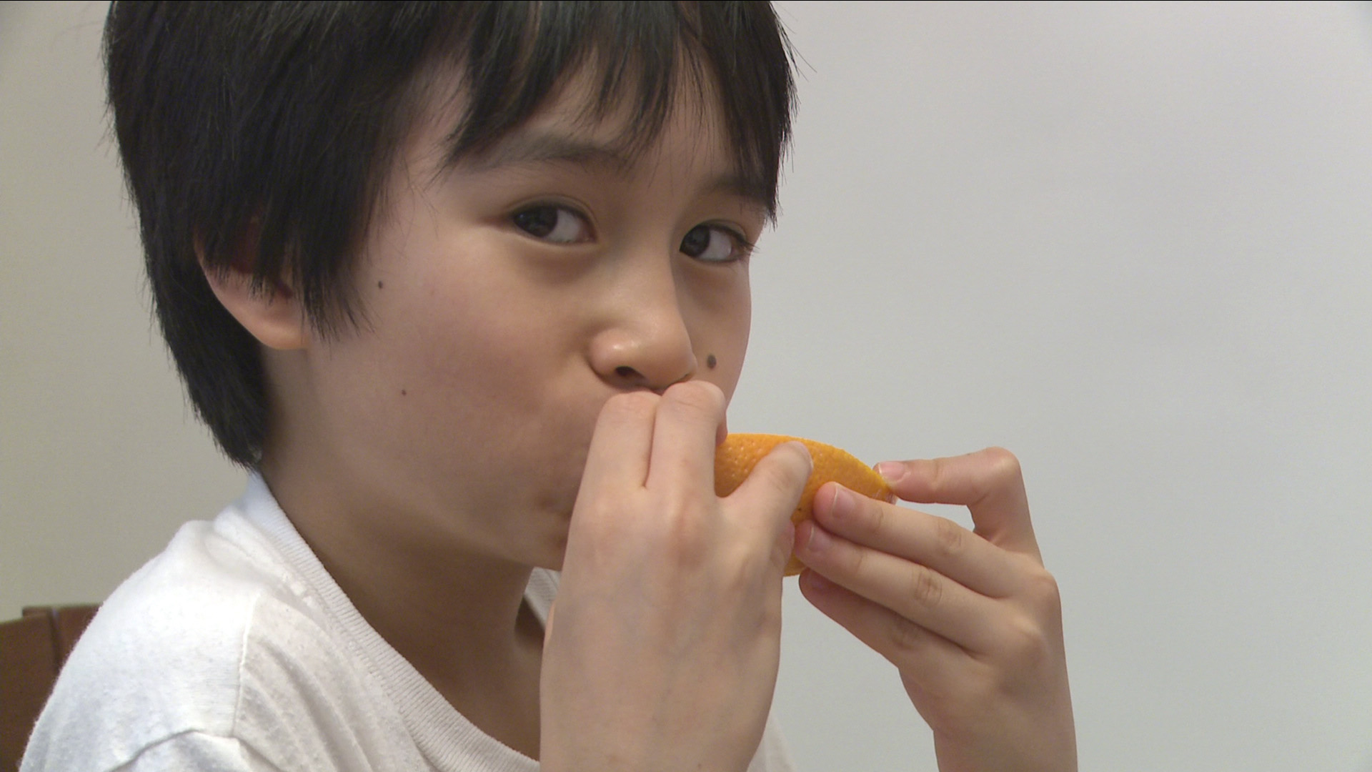

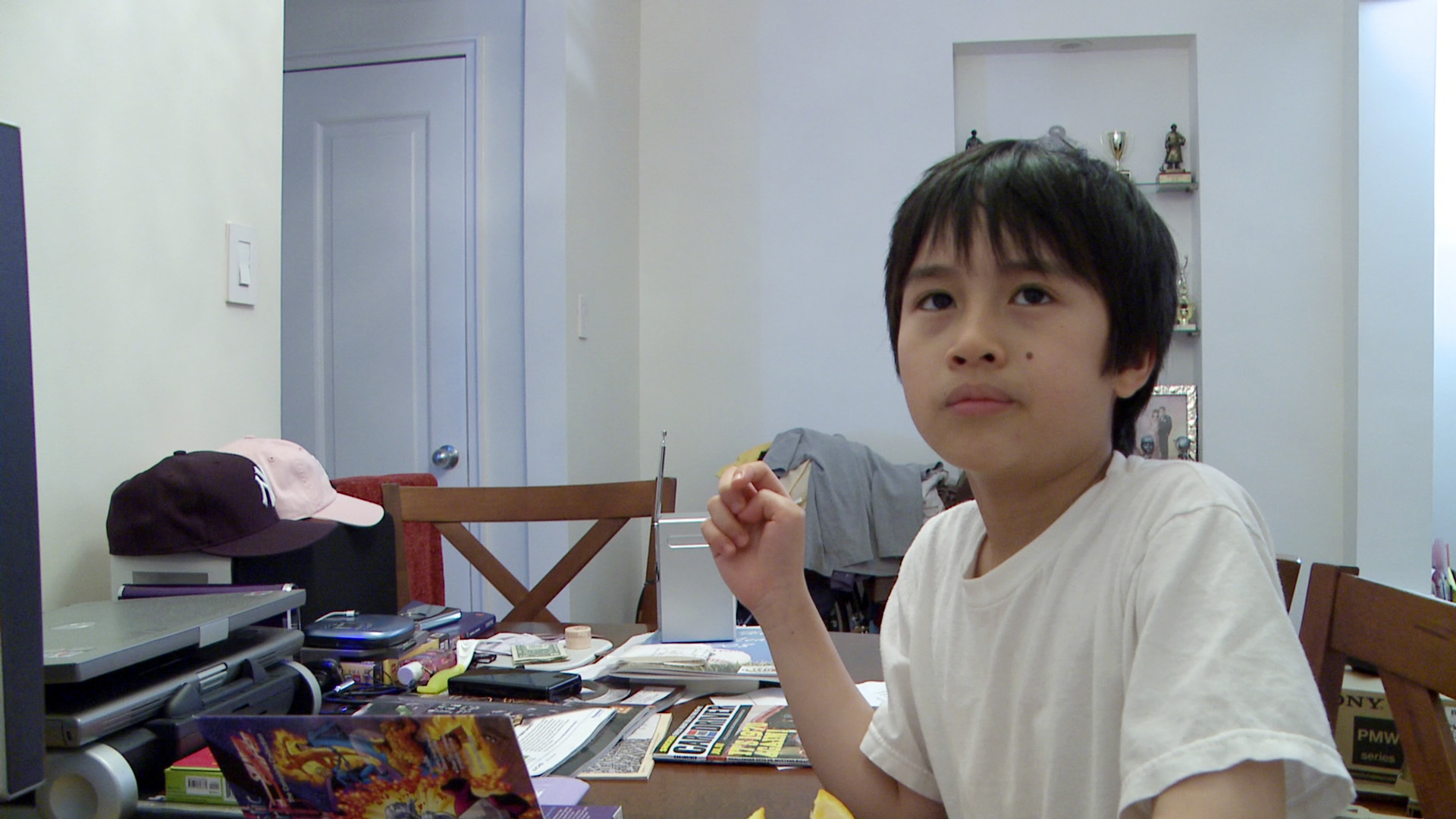

the white balance button works very well indoors.
that button under the lens.
i have at least 3 different type of lights in this room area...
i had the matrix metering on, does not work well with major ambient lighting on the subject's back!
for good lighting and even handheld, as in this case, the resolution is quite impressive.

These look really good. However, the group shots you posted above seem to have a brown-orange tone to the skin. The distance maybe?

i literally use the EX1 right after i received it, so no manuals whatsoever and i used it at a preset white balance when there were no presets.
now i know where the white balance button is and will use it going forwards.
and yes, the group images are brown-orange'ish due to wrong white balancing.
my fault entirely.
