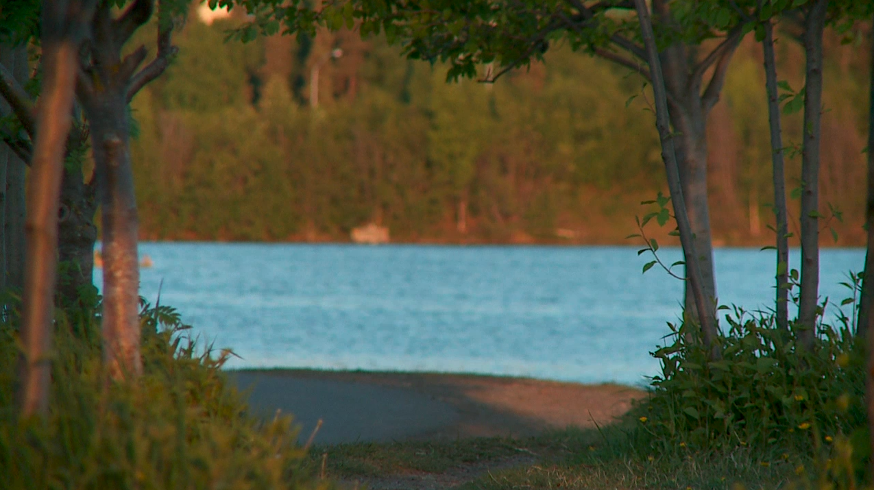

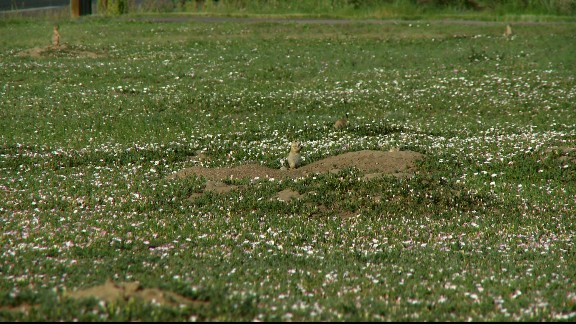

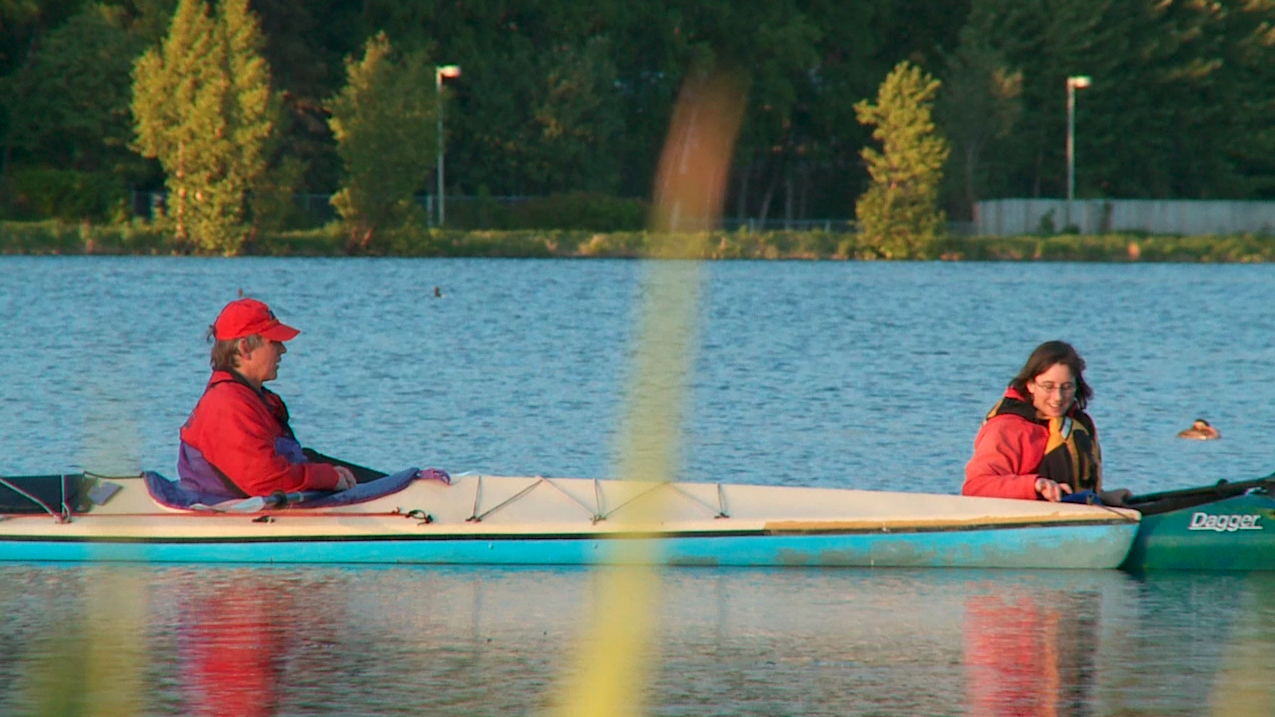

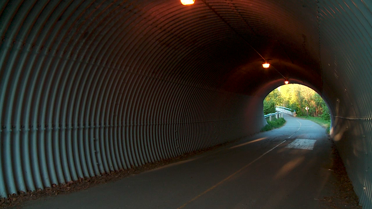

Hey all,
After exactly one week as a proud EX1 owner I've a couple questions regarding the built-in lens. How should I dial in the lens to get the best sharpness, say at full telephoto? Common sense would dictate completely closed, right? But Doug Jensen of Vortex Media says f2.4 to f4, which I've tried.
Once I get my Extreme/Ultimate, will I see even sharper images? Or is this as sharp as it gets, in other words, is the Fujinon the "weakest link" in the Fujinon+LEX/LUL combination?
Next: what amount (if any) of CA am I to expect? Am I correct in assuming that CA is more likely to occur at full telephoto? Will it differ depending on what picture profile I'm using? Currently I use Bill's TC2 Cine1 for sunny days, and Sami's for overcast (Philip Bloom uses this one too).
I apologize if any of these questions betray my ignorance - I'm quite eager to learn all there is about camera work (like, I suspect, most of us here). Do my screenshots look sharp enough? Could sharpness be improved?
How sharp should the Fujinon lens be?-720_24p_1.png   How sharp should the Fujinon lens be?-720_24p_2.png

Hi Gabriel,
I dont think these are sharp pictures at all. In fact they are far from what I get from my JVC111 and I know the EX1 can do a better job. I am keen to learn what the others have to say about getting a sharper picture, re. iris etc

All four frames were shot outside... did you shoot with an ND filter on?
Maybe you have the famous back-focus problem...
PS: I don't think those frames are that bad.

some of the problem looks like DOF issues to me. For example: the river/forrest frame- the shrubbery in the right lower foreground appears to be sharp, and the remaining elements at different distances are out of focus. My experience is that if you are zoomed out much, you will get shallowing of DOF below f 4.0. So the focal plane must be set deliberately and serve a compositional purpose, otherwise you should move to a higher f stop to bring more of the image into tight focus. For me, it is not always easy to see all of this in the LCD, so I use peaking and the DOF indicator to help me understand what I am doing, and help make me think more carefully about what I should be wanting to do with a particular shot.
To avoid DOF issues with the EX, you need to shoot wide, or shoot f8. On the other hand, shallow DOF is a brilliant tool that the EX offers, but seems a bit of a trick to gain mastery of.

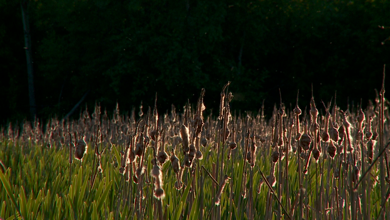

I think this was shot with f2.8-3.4, 1/48th ND2, fully zoomed
It's fairly sharp at the center, but a shallow DOF.
