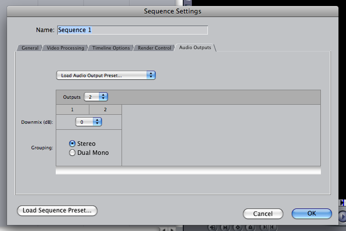

I believe you can change the audio linking inside of FCS after you import your clips by going to the Sequence Settings and click on your preferred audio config.

I'm loading the clips into the Viewer, it is showing as CH1+CH2, regardless of the sequence audio output settings.

Ian, the XDCAM plug-in imports audio as dual mono. Page 26 step 3 on importing clips to FCP, clearly says, "See Sequence Settings (page 36) for more information about presets."
So as explained in page 36 of the manual, you must change the "sequence settings" in the "audio output" tab to "Dual Mono". Then play the FCP sequence and you will see that VU meters confirm that stereo is playing.
