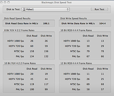

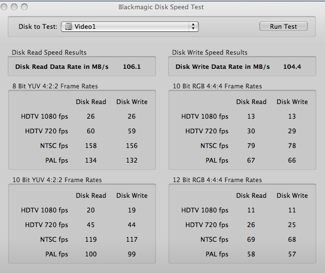

speed test with decklink HD Studio
Hi ,
this is a Blackmagic speed test done on a Macpro 2,8ghz 8 cores - mac os 10.5.4
1 To Seagate esata 32mo cache buffer model ST31000340SV (the disk is free of any file)
8go ram
Decklink HD Studio
it seem to be just to get full hd stream to record on a HDcam deck
I have a Firmtek esata tower and pcie card I have not tested yet to be able to get 220mo/sec .
Sebastien , you can email to me and we could have a talk as my french is far better !
