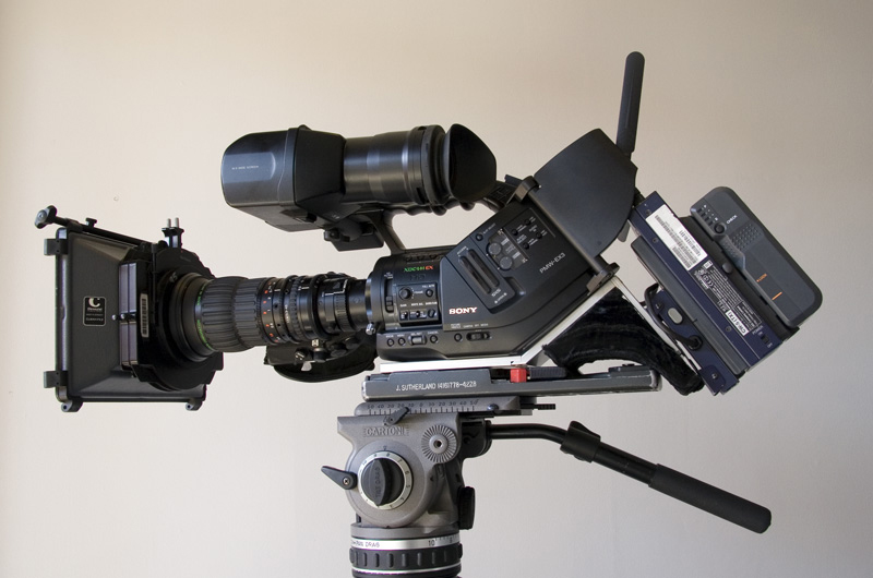

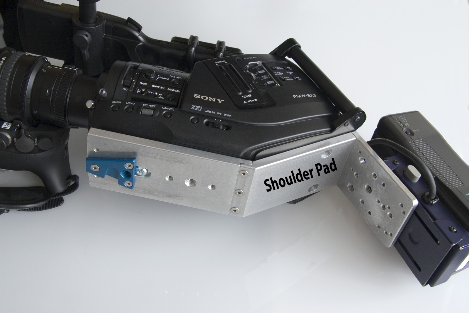

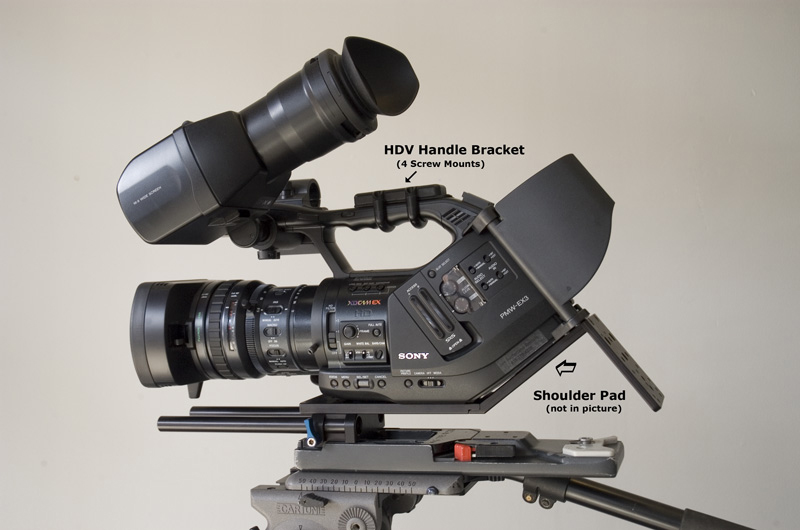

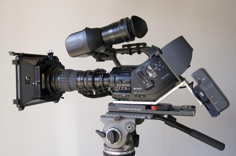

The only way to minimize the mounting screw issue is to get a plate that is anchored on the bottom and the rear of the camera. This creates a secure multi-point grip. Joe Sutherland (www.joesutherland.com) needed to protect his EX-3s rental cameras from damage so he had Precision Camera Inc. (www.pci-canada.com) fabricate camera mounts because these cameras would have a heavier load factor on the tripod screw mount. His prototypes will be replaced with the black anodized versions. The plates are well made and are available at www.vfgadgets.com A soft gel pad can be Velcroed to the shoulder mount and the camera can be clicked into a camera plate. These photos tell the story.
Tripod Fixing on EX3-followfocussetup.jpg   Tripod Fixing on EX3-videotransmitter.jpg
