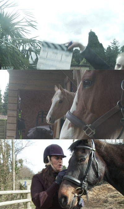

Here're a few frames, it's just from an old shoot as i haven't time to record an A and B but the top two have the pola on and the bottom has it off once i realised what was happening.
Pretty much the same time of day, same conditions and i had the EX1 hood on with the pola on the lens (partly for ND as someone had left the ND grads behind and partly for some shots later on which really would need a pola with water/glass).
This clearly shows the obliteration of contrast from any shooting angle, if the sun was in frame or nearby then you'd see lots of white bright spots like a lens flare.
I didn't realise how bad the contrast loss and messed up exposure was until reviewing footage later, the LCD wasn't so bad.
cheers
paul

The only reason I can think of for a polarizing filter to demonstrate low contrast and "white spots" would be that it was either quite dirty or damaged. I'll pass this thread on to the folks at Schneider for review.

That's the same thing I was thinking, but I didn't want to accuse somebody of having something SO simple as being the cause of their problems. Looking at the shots, I can see that some of them were shot toward the sun which will exacerbate ANY crud on the filter. You could use a dirty ND filter and get the same exact result. If the filter WAS clean, I'm stumped.

The problems you are having are either from a dirty filter (seems unlikely from what you are saying) or a delaminating filter. If the polarization foil in a filter seperates from the glass, you can experience this problem. Also be aware that some B+W filters shipped from our factory for a short time had a slight film on them as a by product of the coating process. This problem was solved some months ago but some dealers still have these filters on their shelves. Be sure that you clean the filter very well with a cleaning solution and the problem is solved.
As far as other causes, ensure that you only have the B+W polarizer on the camera and nothing else. A lens hood works well but to minimize flare issues as well.

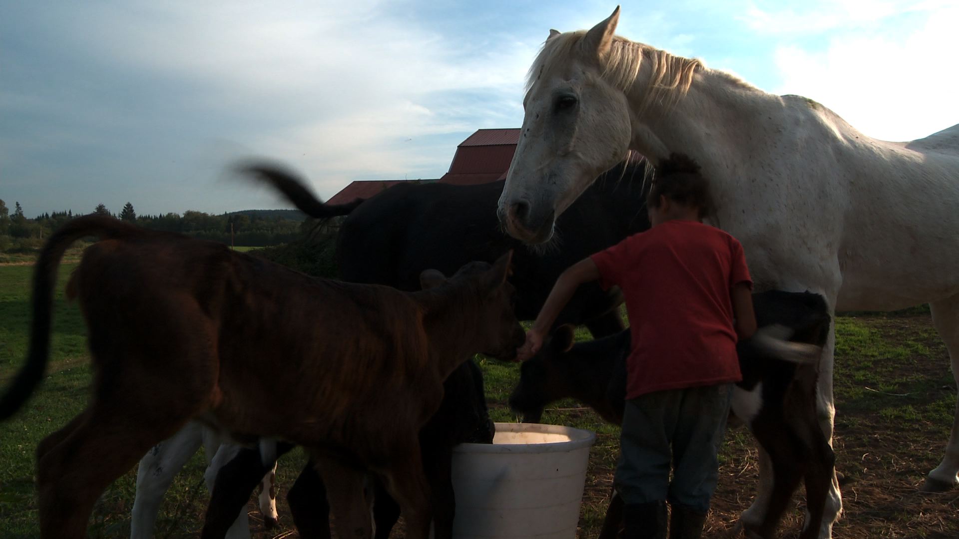

I have a B&W cp as well- just used it for the first time a few days ago. Have a look at the uneven chroma in the sky in this shot. I understand that the sky is overexposed on the right, but is this the way the filter should react in that situation?

Andy, without getting too snarky with a reply, I don't think you are using the Pola in the manner it was designed to work best. This scene is SO far outside of the Pola's effective lighting scenario that I doubt you'd see any polarization effect anyway. What were you hoping to see by using the filter in this shot? The effect of a polarizing filter is seen best when the Sun is at a 90 degree angle to the angle you are shooting. So, if you were shooting at, say, 1 o'clock in the afternoon, the filter would show its' deepest effect on your shot when you camera would be pointed almost due North or NNE. Or, put another way, if the Sun was at your back, point the filter/camera in a line running parallel to your shadow. It's useless on a cloudy day apart from removing reflections from glass windows or very calm water. Or, if you just need even more ND than is available in the camera, you can use it for that, too.

The only problem with that approach is that a Polarizing filter needs to be reset every time you change your direction relative to the Sun. It's not exactly a "set it and forget it" kind of filter. As soon as you turn away from the direction you started with (and set your filter for maximum effect) the filter would need to be reset. It's really an effect filter and not a dial-able ND filter.

that's certainly true, and it's therefore not ideal for verite. at the same time, i've successfully used different polarizers on different cameras in many scenes over the years, and i've never noticed this type of uneven color shift. i suppose it's possible that i've just never noticed it, but i doubt it.
