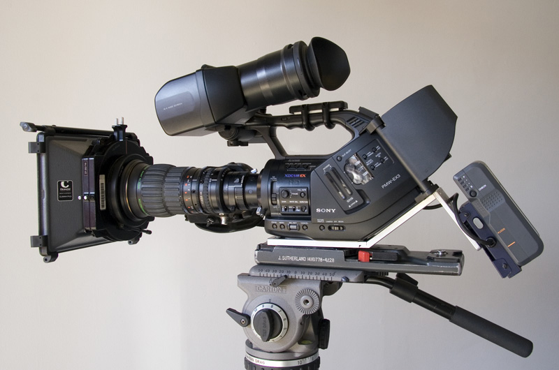

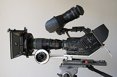

Chroziel Matte Box
Here is an example of a camera plate that is attached to the bottom and back of the EX-3 making it a solid easy to use camera. Joe Sutherland (www.joesutherland.com) had it fabricated after 2 of his rental EX-1s had tripod sockets damage. He wanted to minimize any potential problems with the heavier interchangeable lenses on the EX-3s. Precision Camera Inc. (www.pci-canada.com) in Toronto makes them in a nice black anodized finish.
