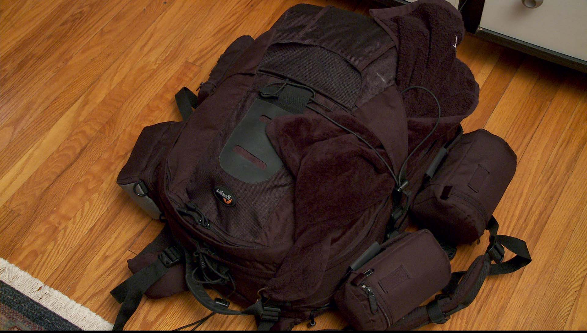

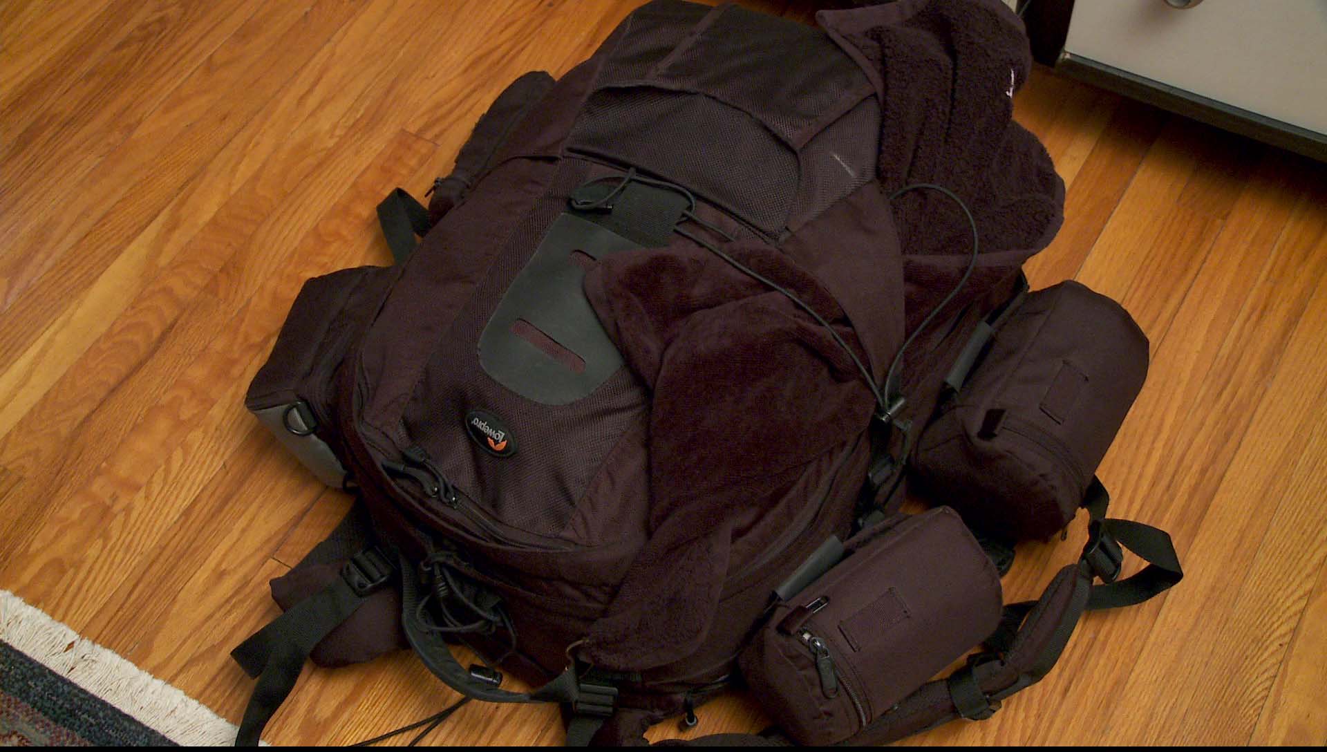

I sent back my B+W 486 to B&H and ordered a Schneider True-Cut 750 77mm from Schneider Optics directly on the direct advice given on these forums by Ryan Avery. It does not work, at least in tungsten only light. Examples:
With no filter, halogen lighting, white balanced on white ceiling provide the light diffusion for the up facing lamp
http://www.atsi.ca/ex3/filter_off.jpg
Same setup with the filter attached
http://www.atsi.ca/ex3/filter_on.jpg
The 486 from B+W worked and made the bag and towel as black as the other items in the shot that show black no matter what. The problem with the 486 was some green vignetting which I wanted to avoid having to correct.
If anyone is contemplating getting the True-Cut, hold off buying it until this is resolved. As it stands, it appears to do nothing in the lighting conditions described. It might have an effect with different light sources although I doubt it.

I saw no bad fringing in my short testing, but it does not cut the IR contamination at all as far as I can see. I would hold off..... Too bad I don't have the 486 still to compare.

According to your posted pics the True Cut is just a very expensive, useless piece of lens protector!!!!

The 486 caused the green vignetting on my camera with the stock lens at the wide end of the range. Fixing or at least partially correcting for the green cast at the edges is possible but correcting for the black IR contamination problem is not without some pretty destructive effects on the image
It appears so for me at this point :(

I can honestly say that we have sold many of these with several extremely satisfied customers. Yours is the first problem I have seen with this so one of two things has happened. Either you received a filter that is somehow not to spec or you have used it improperly. It appears from your tests that you did this under a controlled environment but I cannot say for sure until I test your particular filter myself.
The True-Cut IR 750 requires that it is the first filter the light hits. This because it reflects the IR light. If there is another filter in front of it, it will not work. Also if there is another UV filter in the series it will diminish the effects.
Please see our other extensive threads as to why the 486 is not the best solution for video cameras. It works great on still cameras. The 486 was designed to cut off around 680nm which creates a green cast on the images when a wider angle lens is used such as the lens on the EX1/EX3. The True-Cut IR 750 does not have this problem because it cuts off at 750nm. Because of the higher cut point, the filter helps avoid the near IR spectrum that contaminates the image.
To be clear, it appears that you have a defective filter and I would send it back and we will replace with a new filter. I would encourage anyone out there who owns this filter and is satisfied to post your results. I could post my own images but I think a customer review would do better for us all.
Schneider Optics has no interest in distributing a filter that does not work for the intended purpose and these filters were highly tested before bringing them to market. We offer the finest quality products for professional use. Please contact me via email for any other details.

I want you to understand that I was making no accusations. I understand that errors in production can occur, as well as variance in customer use and equipment. I can assure you that the filter was installed on the front of the stock lens. There is no other non-stock Sony optical element in the optical path.
As I said, the 486 worked in that it removed the brown and purple tinting of black items but caused the green edge problem you refer to. That is why I returned it.
I still need to correct for this problem so I hope a replacement will work. I have already contacted the Van Nuys location where I purchased this from and have an RMA. Hopefully I can get a working replacement fairly quickly.
