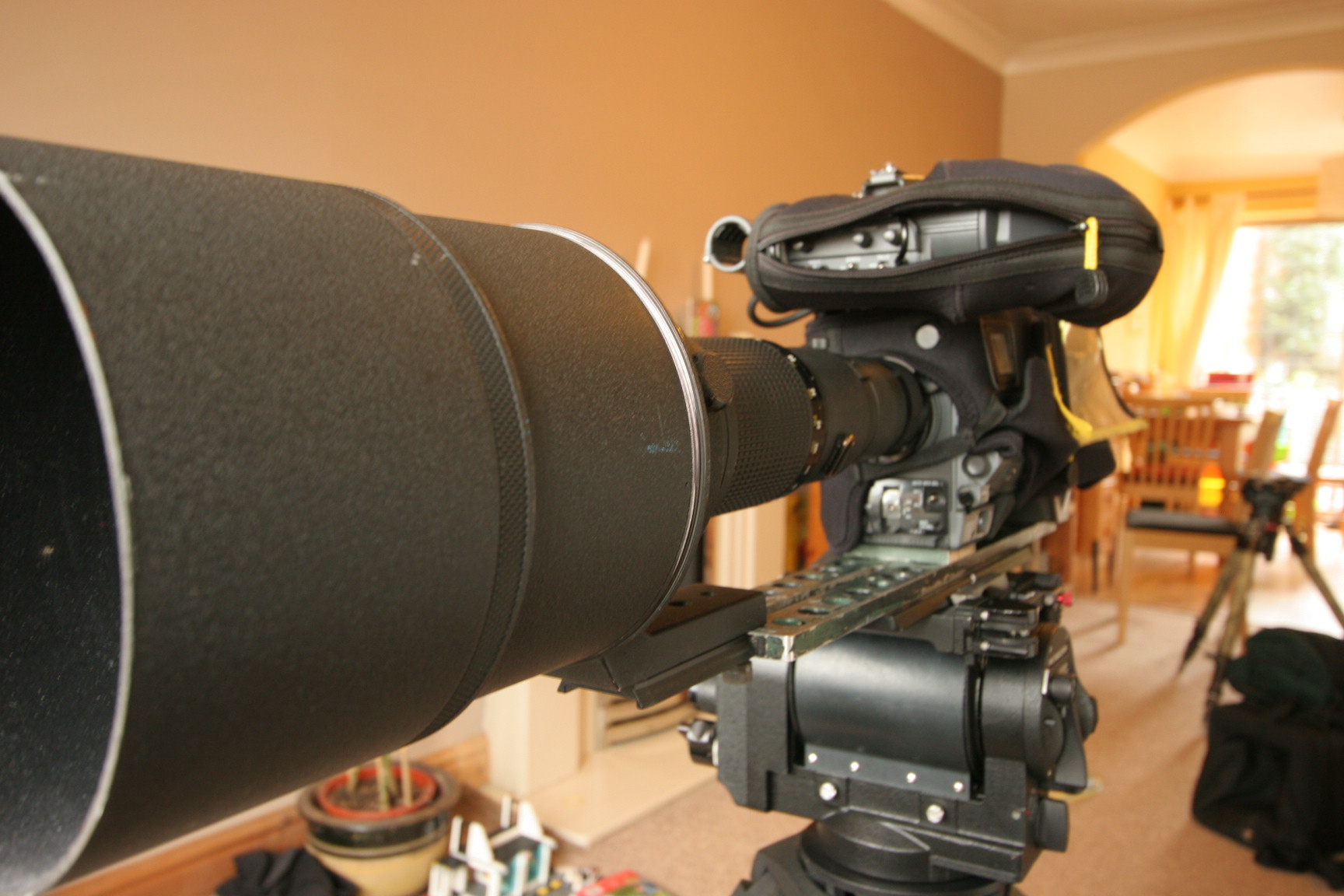

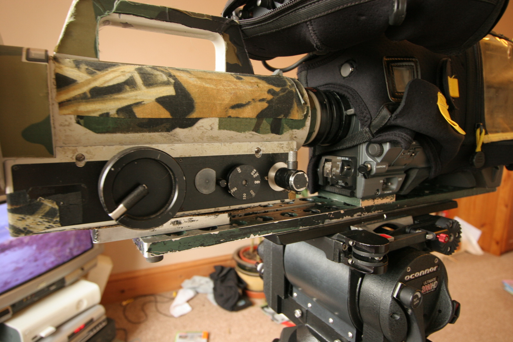

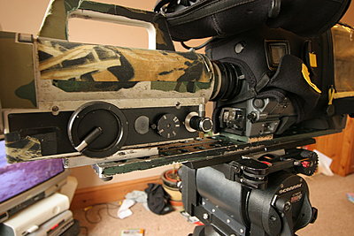

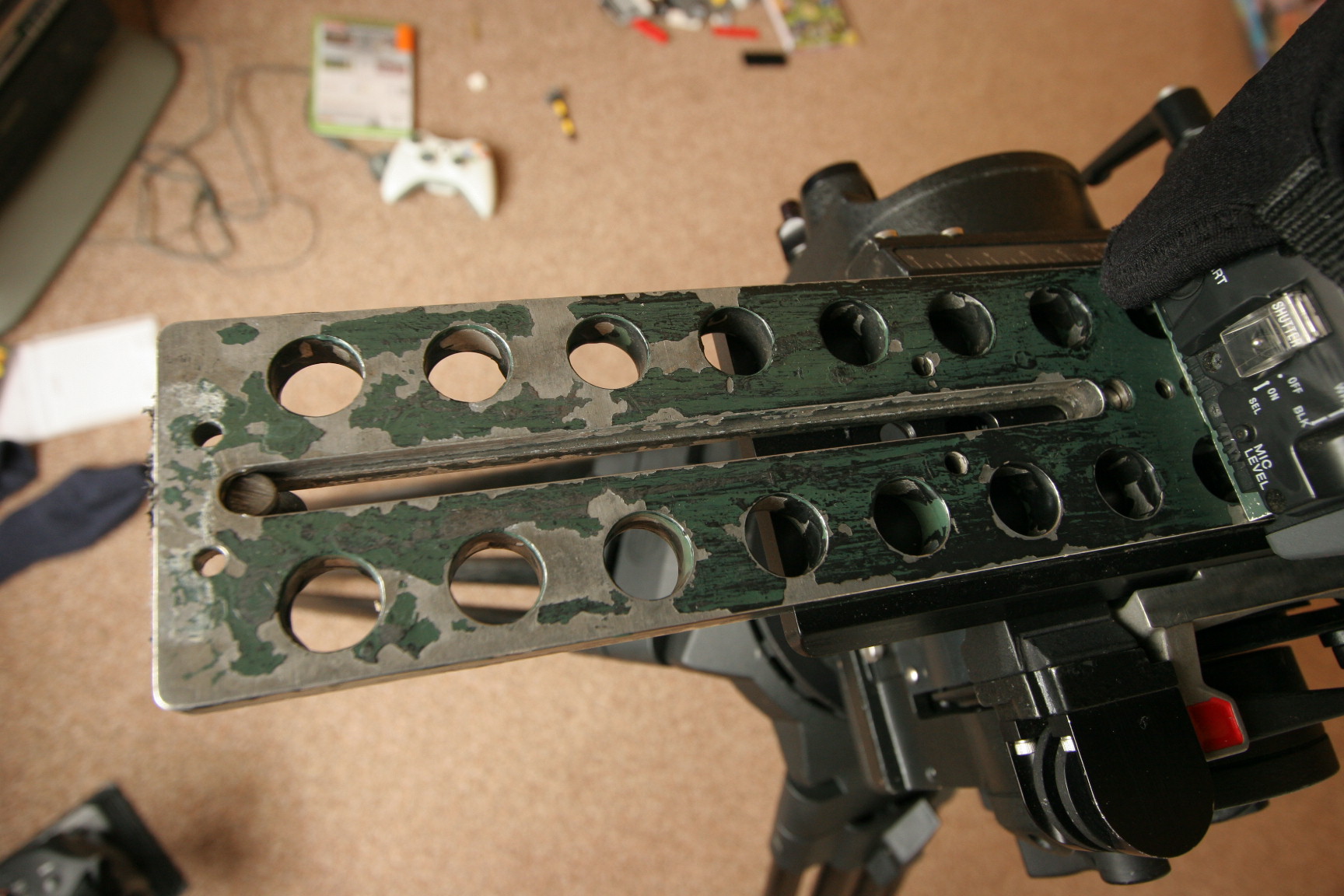

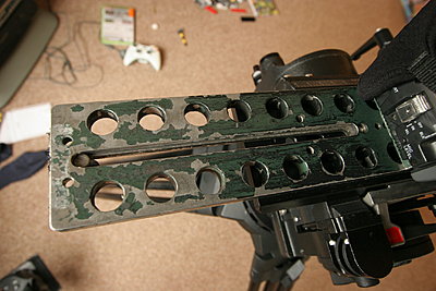

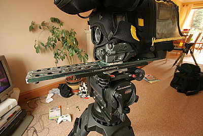

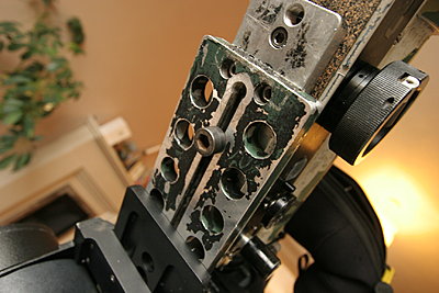

I think a flat plate tends to work best, it's simpler to make yourself than a rail system and is sturdier. With large broadcast and film cameras it's always made sense to attach the plate to the camera then have the lens sit on it, but with small cams like the EX3 the lens foot often hangs far below the level of the camera base so the plate may need to be on the lens.
Here are some shots of my broadcast plate (for Varicam, Sony 750, PDW700 etc.)
It has a little "mushroom" shaped screw at the rear that slides into the groove on the bottom of the camera, then attaches at the front via a spacer that replaces the camera's wedge plate. A groove runs along the front and has a captive bolt which screws into the lens foot (or a spacer to make up the gap - I've shown a Nikon 600 f4 and a Canon 150-600 here).
Hope this helps, be pleased to answer any questions, I know it seems a little complicated, nut it's not really.
You could do the same for the EX (maybe with a spacer under the camera to match the depth of your lens foot).
Steve

The distance between the front of the Nikon 600 f5.6 and the support toe is around 26 centimeters.
Since the camera is around 2 Kg and this is the only weight that effects the camera-lens attachement area - I wonder how critical it is to support the camera-lens combo keeping in mind the stock zoom lens is aroung 1.6 Kg and it doesn't need any support.

Ofer, Mike was referring to the Canon FD lenses that do all have aperture rings - there are quite a lot of cheap ones out there now as stills photogs abandoned them long ago, so classics like 300 f2.8 and 500 f4.5 are real cheap.
I think as well as not ripping the mounts off, the other reason for some support is for better stability, I've always thought if the whole unit was bolted firmly together you'd get less shake, as don't forget there'll be a cettain amount of give in the lens mount.
