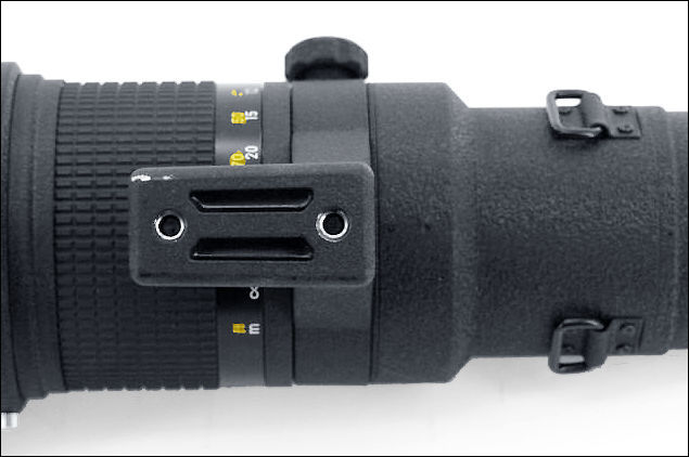

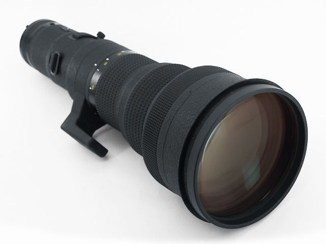

I've attached a couple photos of the 500mm f/4 P Nikkor I'm planning on using with the EX3 (wildlife). Mike Tapa just made an awesome mechanical, glassless adapter for this and I'm looking for some expert advice on what would be the best options to support this rig. I saw Ofer's setup on an earlier post, but it looks scary as far as support. Any more input on how that's working for you Ofer? I'm wondering if a rail kit (60mm length rods) would be the way to go and also what plate, etc.. Steve Phillips mentioned getting a long plate made--I'm not sure where to get that made and specs needed at this point. Just wanted to get a bit more input. I currently own a Manfrotto 501 head at the moment, possibly a 503 if needed, along with a Gitzo 1548 (heavy duty carbon fiber) with a Wimberley head from my outdoor freelance days. Would be interesting to see if that could ever be used with a rig like this. Hoping to get going on getting some good wildlife footage and need to have something as close to rock-solid as possible. Anyway, Ofer, Steve and anyone else---thanks for your input on this.

Just wondering how usable a 2500mm lens will be? You'll need to be shooting through cold clear air!

No doubt there. Here in Michigan we've got plenty of that. More limited use with the 500---but there have been a couple instances I could have used it. I've used it on an GY-HD100 for brown bears in Alaska and with the right conditions and a sturdy tripod you can get some decent stuff.

I've just got my EX-3 adapter from Mike and was trying to figure out the same thing for 300 and 400 mm Nikon lenses. The best solution I can find to date is a very long rails system with a Brevis proteus Cinevate Inc. system to raise either the camera or lens depending on the configuration and a regular rails mount at the other end , my favourite being the red rock one microShoulderMount Rod Clamp
A simple metal plate may be an alternative. Have a look here http://www.dvinfo.net/conf/canon-xl1...s-support.html

Hi Steve,
I am definitely not an expert as I recently moved to video after years of still photography.
I am using the EX3 with a few Nikon lenses. Since I prefer to use prime lenses over the zoom, I take the whole arsenal to the field - 300, 400, 500, 600 and keep changing lenses. As scary as it looks I decided not to use any support system for the camera+lens combo. Firstly because it is not practical to keep changing lenses and re-adjusting the support system and secondly - I am not 100% sure the support is really necessary. I attach the camera+lens combo to the tripod head via the lens "leg". The camera is basically hanging on the lens so only the camera’s weight (about 2 Kg) is the factor to be considered.
Regarding a fluid head - I have tried the Vinten vision3 and found it to be unsatisfactory for such long lenses (1600-3300) so I bought the Miller Arrow 25 which is a FANTASTIC device. I attach a rubber band to the handle and manage to get very smooth, vibration free movement even with the 600mm lens.

I'm coming from the same still photography background as well. I'm just a bit worried the EX3 will be alot more weight on the lens mount than my old F5. However, will be interesting to try it out. I do have one other question---in researching this more, you are the third person I've come across who mentioned using a rubber band for pans. Are you talking one of those huge 1" wide bands or just a normal one. That's a great idea that I will have to try. Thanks.
