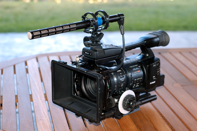

I use the shoe mount version of that same shockmount on my EX1 with my Sennheiser 66. Works fine but it won't fit in the case with it on (Kata CC-10A). I slip it off the shoe and place next to camera in bag. No biggy.
need mic suspension that fits on Sony mic clamp: suggestions?-ex-1-5597.jpg

Ronn, I use this same shoe mount on my EX3. Take a closer look and you will see that it comes apart with two screws, such that you can eliminate the middle piece. That lowers the height by more than half, provided you don't need the tilt "thingy". I have also opted for the DM-Accessories EX3 compatible mic mount as replacement for the stock Sony "flimsy thingy" which I removed as soon as the EX3 came out of the box. Cheers!
I have a little tip regarding your shock mount (it looks like Røde SM3), I just discovered something when answering Malcolm's question.
If you don't need that "knee" on that shock mount and want to reduce the height, you can remove that knee segment from the shock mount assembly and drop the height of the shock mount by 1 1/4" / 30mm. My SM3 didn't include instructions or any paperwork that said this would work, but it looks like it was designed to work that way.
