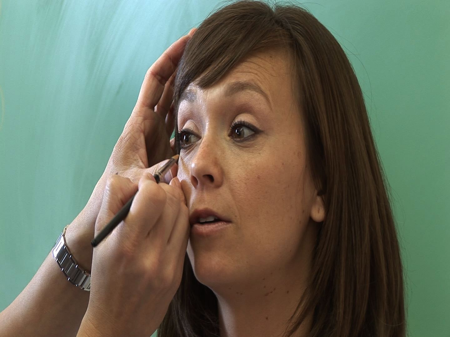

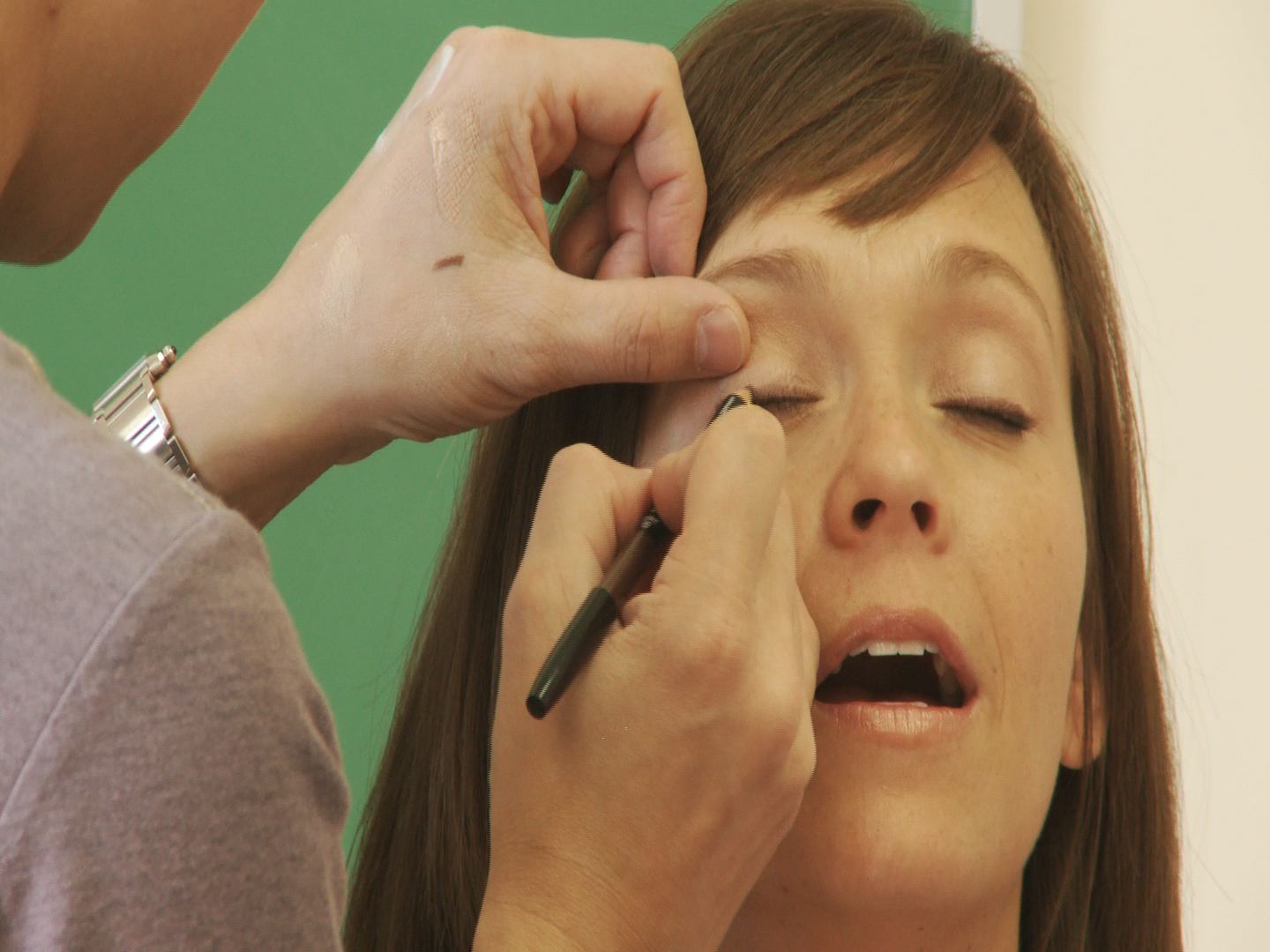

Old October 28th, 2008, 11:23 AM   #8
Location: Lexington, KY
Posts: 692
screen grabs
now that I am into this wedding, here are some comparison grabs. i will post the Z1
first, the EX1 second. I did the FB procdure, but have yet to shoot anything to check it out.
Seeing this makes me regret selling my FX1, should have left well enough alone.
Soft Video, Not at all happy-z1grab.jpg   Soft Video, Not at all happy-ex1grab.jpg
Scott Hayes is offline   Reply With Quote
Old October 28th, 2008, 11:37 AM   #9
Location: Tallahassee, FL
Posts: 4,100
Dude, your camera is broken. Get it fixed. This shouldn't even be close. My EX1 would have to be focused 3 feet short for it to be that soft.

Old October 28th, 2008, 11:49 AM   #11
Posts: 692
yeah, as you can see from my sample, my Z1 kills it. Do you recommend it a trip to Sony, or do the FB procedure again?
Old October 28th, 2008, 11:54 AM   #12
Location: Wales
Posts: 2,130
It kind of looks like different detail settings on the 2 cams? The EX image, while softer, actually looks nicer to me, the Z1 looks really oversharpened. Have you turned the detail setting down a lot?

Old October 28th, 2008, 11:55 AM   #13
Posts: 4,100
Let Sony fix it. Trust me, when it's working right, it's like looking through a frigging window. Best handycam image I've ever seen. Bar none.
Old October 28th, 2008, 12:04 PM   #14
Posts: 692
this camera had Phil Blooms settings on it, and I was shooting with those. The Z1, my assistant was using, shooting on auto, out of the box settings.
