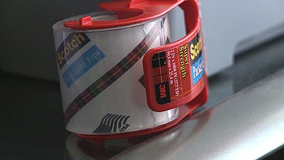

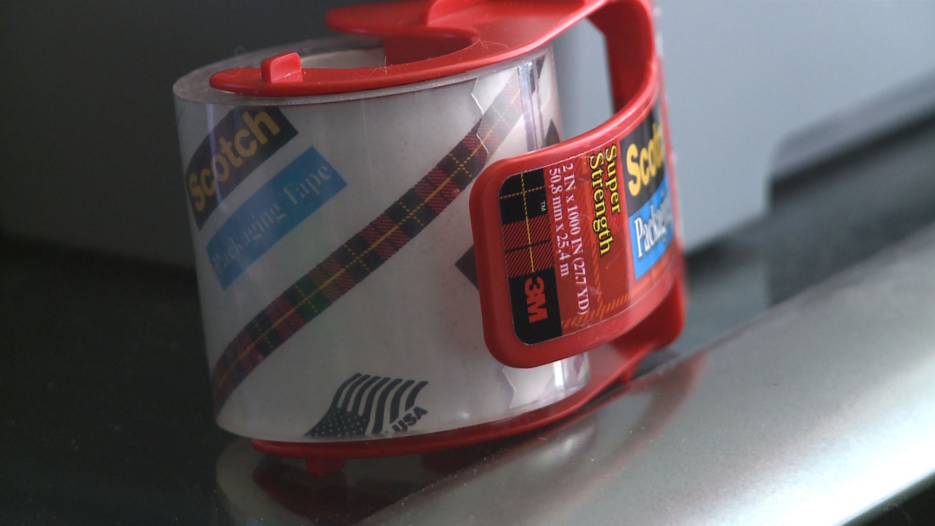

Could you provide a better comparison?
The color balance and overall look are so different, I'm not sure about the question.
Also, the Z1 image has a lot of artifiicial sharpening over the EX1 image you provided.
Although the EX1 shot does not look that good in the example, I find the Z1 to look
really harsh due to the sharpening. This screams video.
If you do not like the EX1, why hold on to it. Just sell it.
If it's not a back foucs issue, there might be something else wrong with your camera.
It's certainly hard to tell from one frame.

There are 3 issues:
1.) sharpness (detail setting) is ON for the Z1 and off for the EX1.
2.) more depth of field in the Z1 pic means it was probably using a stopped down aperture
3.) The EX1 is shooting in its lower resolution HDV mode SP 1440 x 1080.
Comments:
See the halo'd outline on the hand and wrist on the Z1 image? That's excessive artificial sharpening being applied to the image. My personal opinion is the softer EX1 image is more professional looking in appearance. But if you want it to pop, Phil's film-like preset is probably not the best choice. You also still have the option to shoot full HQ 1920 x 1080 mode.
You've left a lot of chips on the table, if sharpness is your goal. You have many options to make it zing. To start with, go to the last post (mine) in the EX1 picture profile recipes (one of the sticky threads at the top), and use my detail setting. Then choose gamma std3, then for matrix choose normal or standard, +4 on the saturation.
One last note, if you are right in the face of your subject, the minimum focus distance on the Z1 is about 1/2 inch, on the EX1 it's several feet unless you switch macro ON. You may have been too close to your subject.
I owned the Z1. It was a great cam back in the day, and still holds it's own by any measure, but the EX1 image is seriously more detailed.

Different angle from that example, the Z1 has some side light, that will enhance details, there is no way the Z1 can be sharper, but if you are not liking it at all, we can do a trade, I will buy you a brand new Z1 and you will give me your EX1(-:

Tom, thank you for your post! this is exactly the kind of info i needed. i am looking at video I just shot on my 1080P Sony Bravia, and damn, i am smiling now.
