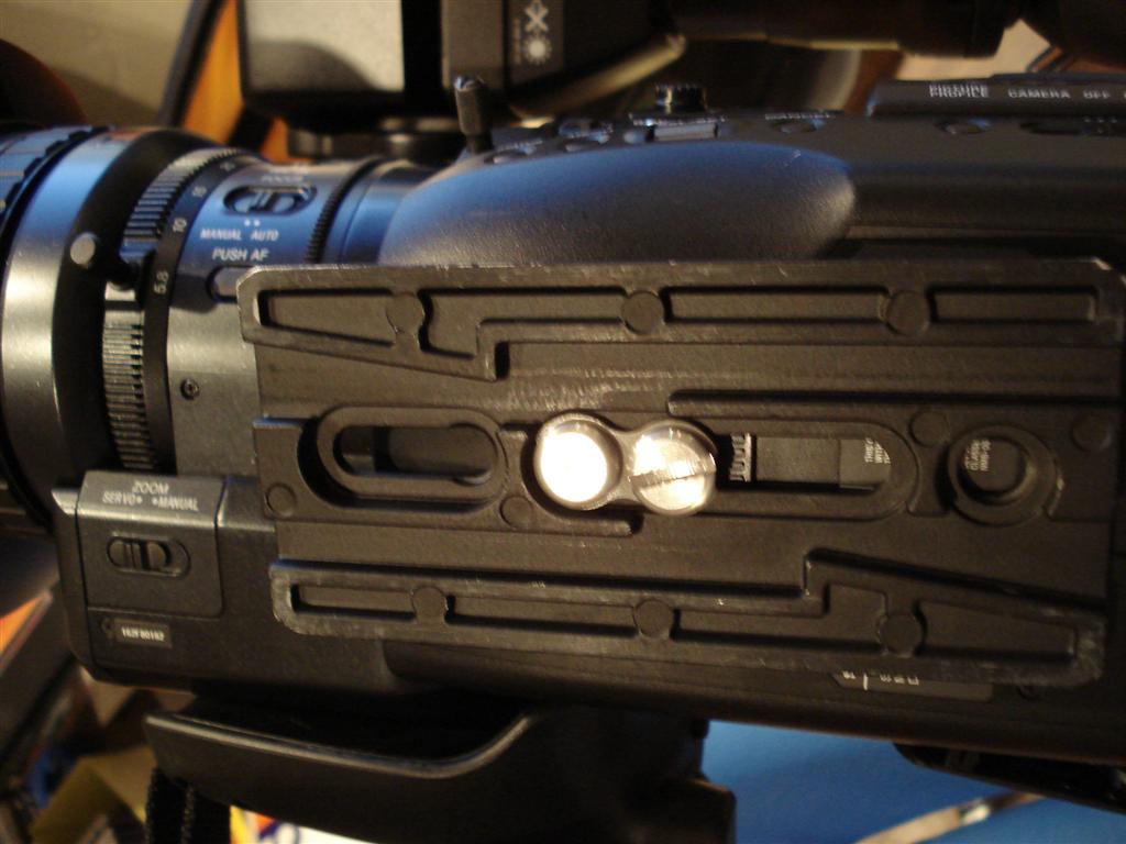

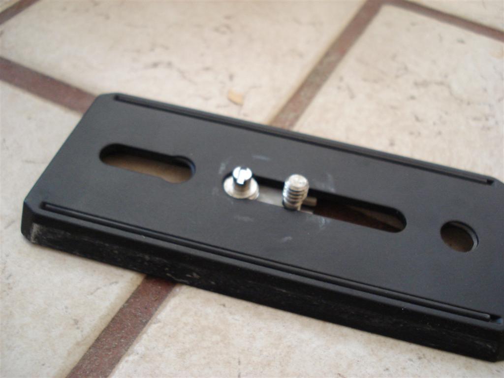

Ted--is the hinge plate removeable? Also, would the base accommodate this Vinten base plate?

His plate is meant to stay attached, and go into a quick release plate. You would just attach your Vinten plate to a VCT-14 camera plate. Or even better the shorter version.

The hinge plate is removeable.
The base can accommodate many common quick release plates, such as yours. The wedge for the VCT-U14 is just an optional means of attaching the camera / plate combination to a tripod with a VCT-U14 mounted on it. It looks to me that your plate will screw in just fine.

Jeff has already drilled and tapped several holes in the bottom - it should accommodate your tripod plate just fine. His holes are tapped 1/4x20.
