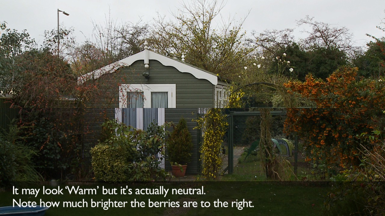

But before it goes that far, I chopped this out. It's not exactly Cambelles, and it wasn't going to be used as any form of rigourous test, but it sure does show the benefit of a decent white set on a good white card.
No, it won't have you reaching for the ketchup and putting your shoe in the oven yet, but there is more red in the upper portion, the orange berries on the right have more detail, the sky is far more neutral, yada yada yada. The information that's in the top half cannot be in the bottom half as it's a balanced attenuation (Okay, looked at immediately after the previous 'ATW' shot, it looks warm - but this is the neutral card, but I digress).
And here's the Astroturf moment: I'm arguing for white cards over scraps of paper at the moment.
