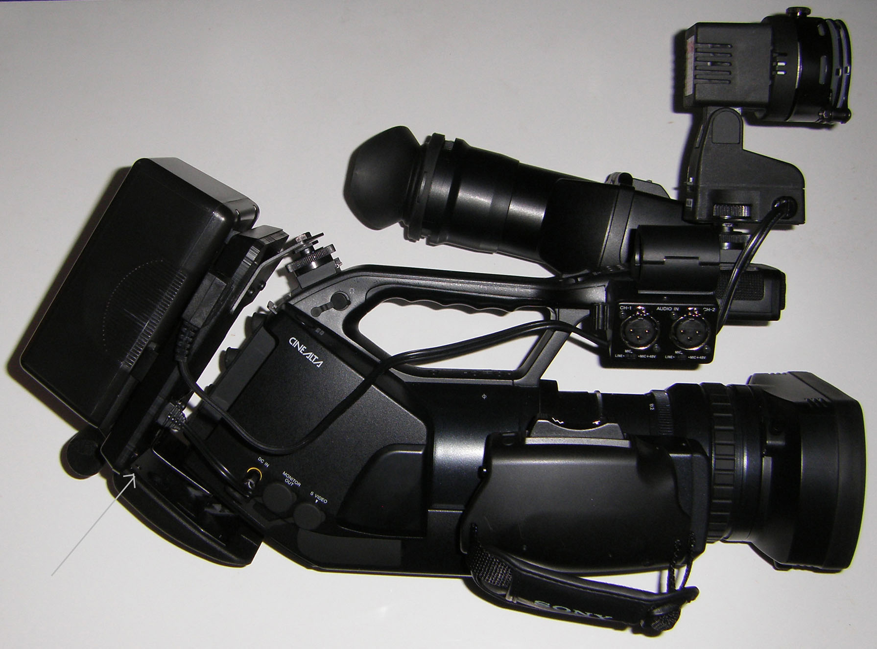

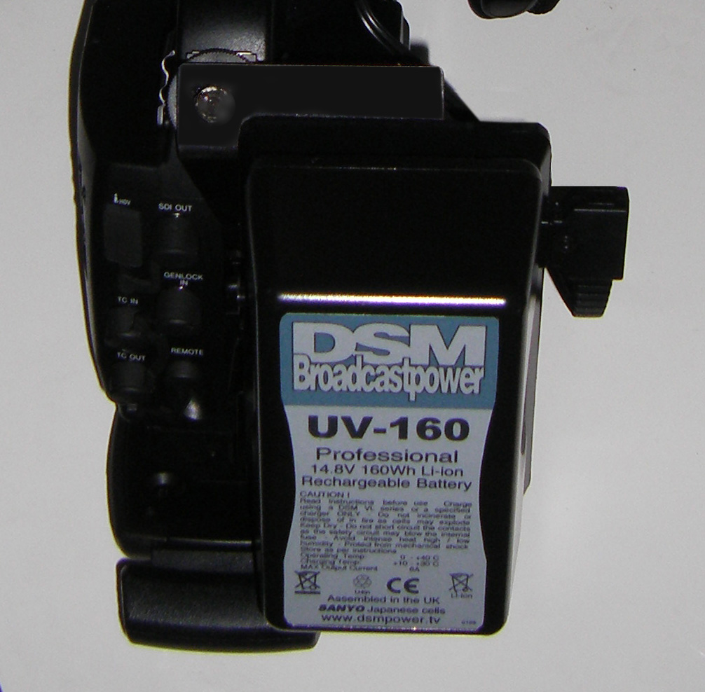

Old February 4th, 2009, 06:07 AM   #21
Join Date: Oct 2005
Location: Haydock United Kingdom
Posts: 12
DSM EX3 Battery adapter
Originally Posted by Simon Wyndham View Post
One of the reasons the AB adaptor looked good is because it is about the same price as one SWIT battery, yet it allows me to use all of my Dionic 90's.
I wonder why they didn't make it snap into place like the original battery.
Hi
I have now designed V-Lock and Gold Mount battery adapters for the EX3 photo attached
These will be available from H.Preston Malvern url=http://www.videokit.co.uk
They will also have kits containing Batteries, a light and charger.
EX3 BP-U60 bat vs AB Dionic 90-dsm-ex3-1lr.jpg   EX3 BP-U60 bat vs AB Dionic 90-dsmex34.jpg
David Martland is offline   Reply With Quote
