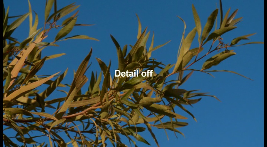

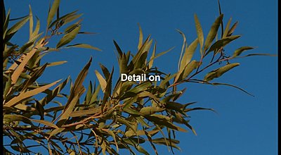

I couldn't stand it I had to post...LOL I know nothing about this but this is what I did.
I did a MXF full res 1980x1080 edit, rendered as full res MXF.
Reset project to NTSC DV widescreen 720x480, EX detail off and on, rendered as a DVD architect 720x480 widescreen mpg.
Pulled the mpg back into the timeline and snapped these.

That sample I posted, if you watch the actual video (I didn't upload the video) I shot that scene because of the bright background and all the fine detail. I was trying to reproduce the twitter. You could see it in some of the diagonal leaves and stems but it was worse with detail on.
Honeslty detail on did make the whole video appear more 3d, but it had more twitter so I guess it depends on what you want.
