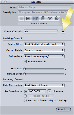

When using compressor you should activate the advanced Frame Controls and select the "better" or "best" resize filter. Turning Anti-alias up to around 40 or 50 reduces any jaggies.
Doing this makes a huge difference to the quality of any frame resizing such as from an EX to SD. You can set this up on any preset so you can go straight from the timeline to m2v for DVD or DV or H264 in one hit. Renders do take longer but you only have to do the one step.
