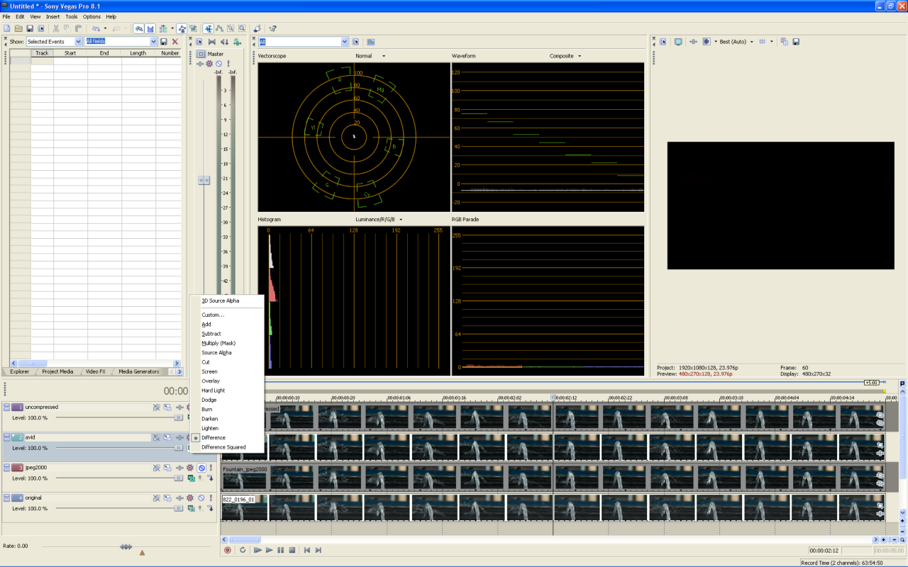

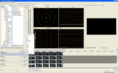

Originally Posted by Dominik Seibold View Post
I used XDCAM-EX-source for testing. I attached an 100%-crop-example. The left side is avid with 36mbit/s, the right unaltered XDCAM. There are clearly more artifacts on the left side.
Ok,
So here is a screen shot of my editing space. Essentially, I took 5 seconds of a closeup of water on a fountain. So organic movement, and unpredictable by the codec for the most part. I stacked the original, and uncompressed, a jpeg2000, and the DNxHD175 on the timeline.
I then did a difference composite for each one. I have highlighted the Avid against the original source. I have histograms (Luma, R,G,B), Waveform, Vectorscope, and RGB Parade open as well as the preview window.
You can see from this that there is nearly NOTHING. For all intents and purposes, DNxHD at this bit rate is lossless when presented with an XDCamEX image.
[Edit]
Oh, file sizes for 5 seconds of 1080/24p:
Uncompressed: 972,008
Jpeg2000: 114,882
DnxHD 175: 107,522
HD>SD downconversion Mac/FCP only-fountain_comparo.png

Interesting results, Perrone, thanks for posting.
