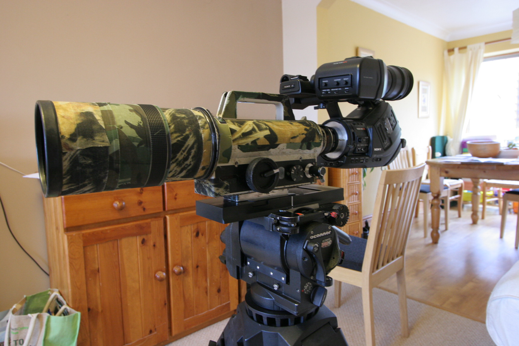

Oh, and just found this pic of the very combination that was asked about - EX3 plus Canon 150-600 for those interested!
Steve

We used to use those Canons to shoot windsurfing back in the 90's. Ours had Sony B4 mounts and motorised zoom.
Old June 25th, 2009, 01:18 PM   #20
Location: Wales
Posts: 2,130
This one had a motorised zoom but I removed it, it's only really good as a variable prime anyway and doing it manually saves lots of weight and bulk! Both the 150-600s I;ve had have had Universal mount and I've used them on Super 16, Digibeta and now HD, as well as 35mm and digital stills! Versatile bit of kit.

That lens brings back memories Steve.
We converted loads of these when I was at Optex.
Who did your conversion?

It was done before I bought it, but it was Optex for Panavision.

I think this is what you are looking for....
... if the lens is PL mount.
PL to Sony PMW-EX3 adaptor

Unfortunately the Russians will become nervous with that
lens/adapter since the focal length becomes 2325mm. :)
More like 3240mm
Don't forget, regardless of the mount fitted, it is still a 150-600mm that covers 35mm stills format.
In this case, angle of view will be equivalent to 5.4X focal length.
Mike Tapa
