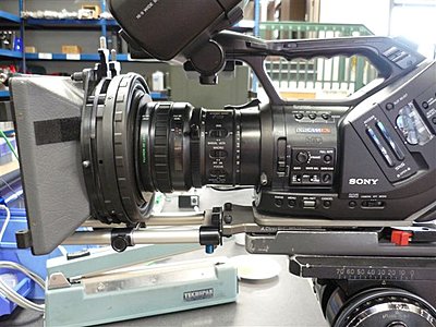

Originally Posted by Jeff DeMaagd View Post
Thanks for the info on Chrosziel, there are a couple people I should notify about this. I am considering the EX1, I think I can solve that problem.
The 85mm donut insert fits nicely on the front of the EX-1. Clearance at full wide at Z1.
