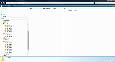

I have two BPAV directories that seem to be corrupted. The CLPR and the TAKR directories and intact as are the .mp4's and other files. When I goto clipbrowser however, the clips show up as black with a white X in them. I know why this happened, my associate didn't use the clip browser to copy the files. Lesson learned but I wonder if there is anyone else who has dealt with this problem and could offer any remedies.

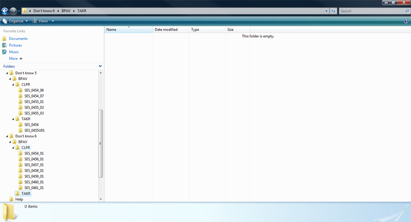

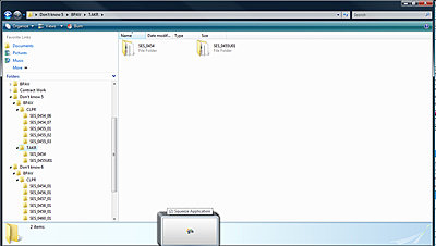

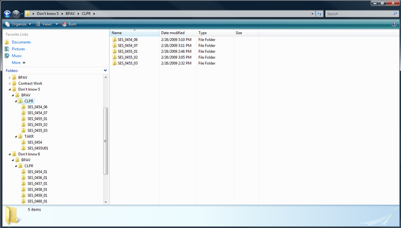

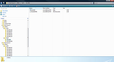

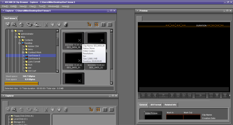

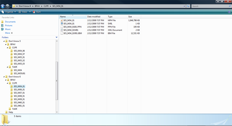

They will not play in VLC player either but the filesizes of the mp4's indicate that there is some semblance of information. I've attached screenshots of the directory tree and files along with the Clip Browser error.

I still cannot resolve the problem. I've tried to let the EX 3 "rebuild" the media by copying back to the SxS card and restoring it, to no avail. The closest I get are 5 black clips in the media browser on the camera. I'm going to keep working on it more today and will check back intermittently. If I come across a solution I'll be sure to post it here.
