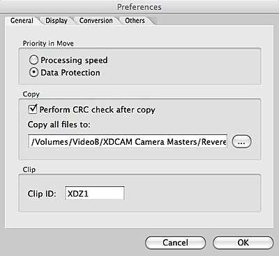

Here's the preference setting for CRC

Thanks, Craig-
after a little more research, I discovered that I have been operating with Clip Browser 1.1. It didn't have the CRC feature.
Since posting that last message, I've already downloaded 2.0 and am transferring clips from today's shooting as I write this.
I'm out of town on a shoot with my EX, and was a little nervous about trying a new Clip Browser while on a shoot, but now I'm glad I did. This one works much better, seems faster, and of course has the CRC feature which will let me sleep better tonight....

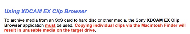

From the FCP ClipBrowser 2 workflow PDF note this very emphatic warning.

Damn.... that's ominous. I have always used Clip Browser, but know several people who just 'drag and drop' I wonder how they've made it this far without a disaster?
www.zooprax.com
