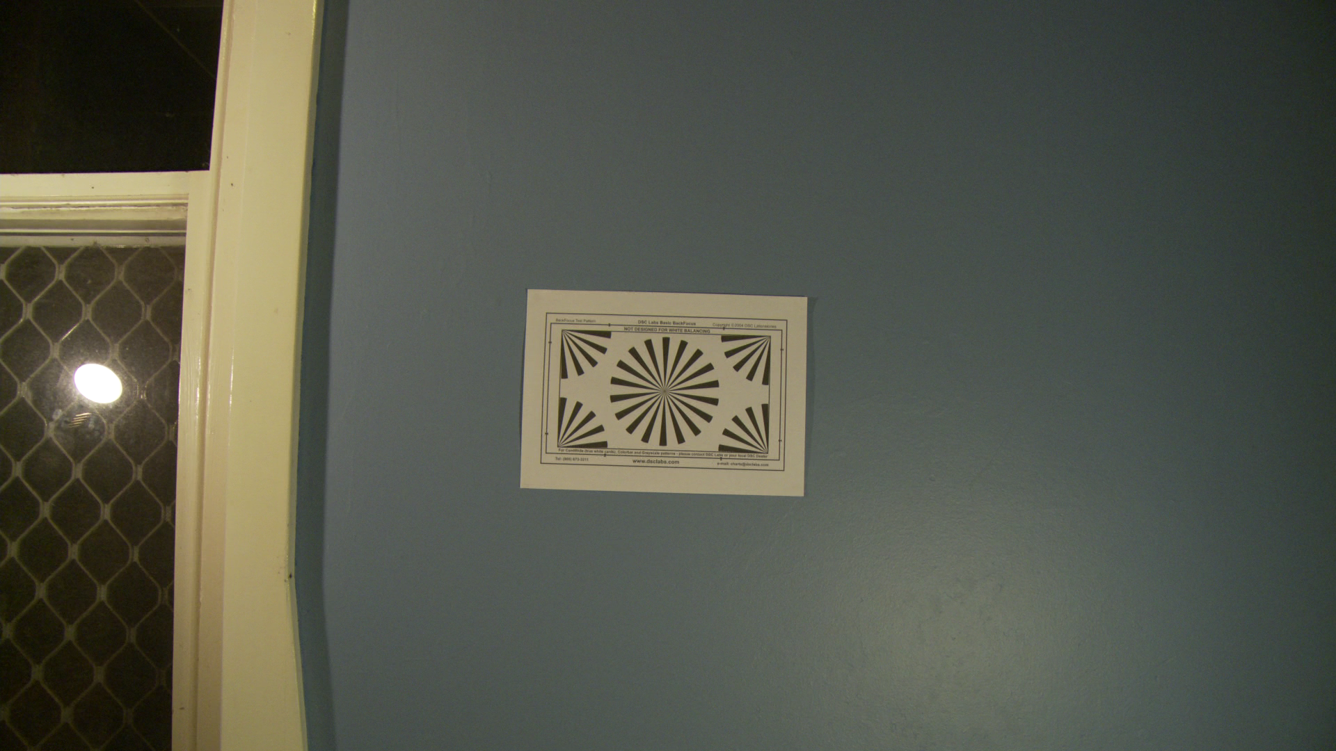

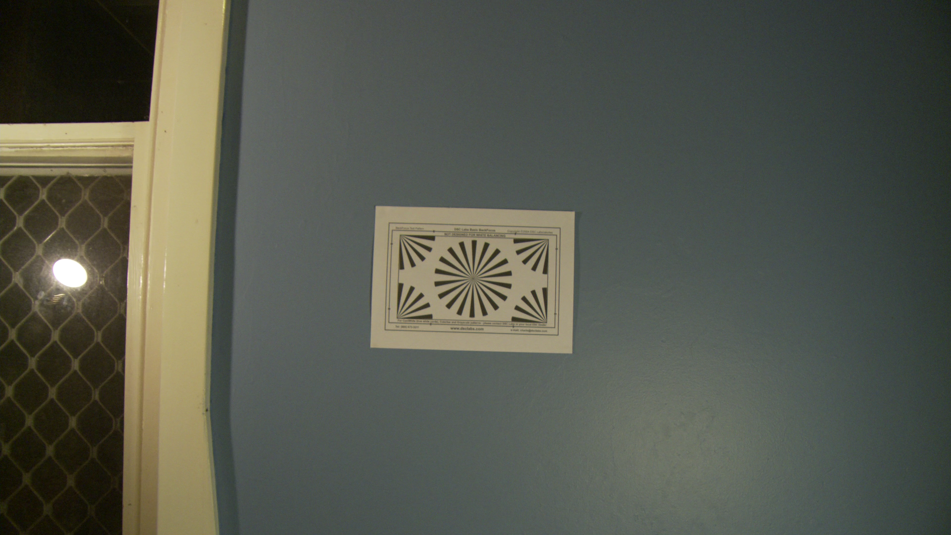

damn you soft focus
Happening again, i think it is because i'm using such a small chart. Maybe if i moved the camera closer than 3m, the book says 3m though. Is that ok?
See I zoomed out of a sharp focus and it went soft, I was able to make it sharp again by adjusting the focus when zoomed out... Should it really be this hard to get a sharp focus? I have firmware version 1.3

If you take your lens off, or use the camera in a dramatic change of temperature then you should perform the lens adjustment again.
Also what aperture are you using?
smaller f stops than f8 can lead to soft focus, although the depth of field will be greater.

Are you focusing with the lens zoomed out - i.e. wide, or with it zoomed in (telephoto).?
I presume from reading your post's you are focusing at telephoto and then zooming out
Does this happen every time or only occasionally?
Are you using a manual zoom or servo zoom?
Do you have a UV filter on your lens, if yes then have you tried to zoom in and out with the filter off.

I use manual zoom and I have a UV filter on the camera. I didn't realise it could effect it.

My first stop would be to repeat the test without the UV filter.
When manually zooming are you using the lever or turning the ring, make sure you are not catching the focus ring at any stage. It looks like your focus is only out by a small amount.
The other thing you may want to check out is the diopter setting on your eye piece. Make sure that you focus your eyes on the various symbols and viewfinder information. Your subject matter will be on the same plane of focus.
When I first started photography, I did a test by focusing on a subject, take a picture, then reset the focus to infinity and focused up again. I would do this at least six times. You would be surprised at how much focus variation between shots could be seen. After a bit of practice I managed to achieve a higher success rate.

Thanks for the tips, I pretty much tested it every way possible, as per your suggestions. The problem was almost solved by doing the back focus adjustment closer than the recomended 3 meters. However middle distance focal lengths became soft, when I did that.
Everything usually looks OK through the viewfinder, but I know it is soft because the peaking shows I can go sharper. Screen grabs from XDCAM clip browser also show that it is soft and can get sharper (see above). I will take it into a service centre this week, I just hope they can help me. Maybe I should ask for a firmware upgrade - does that cost anything?
