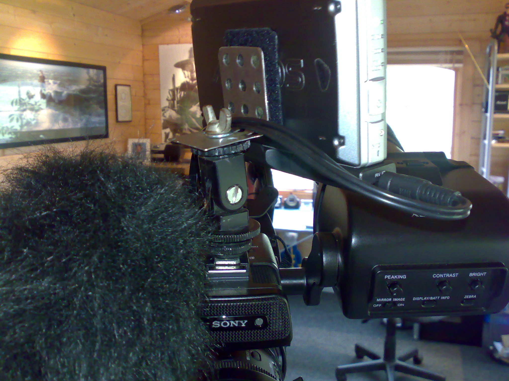

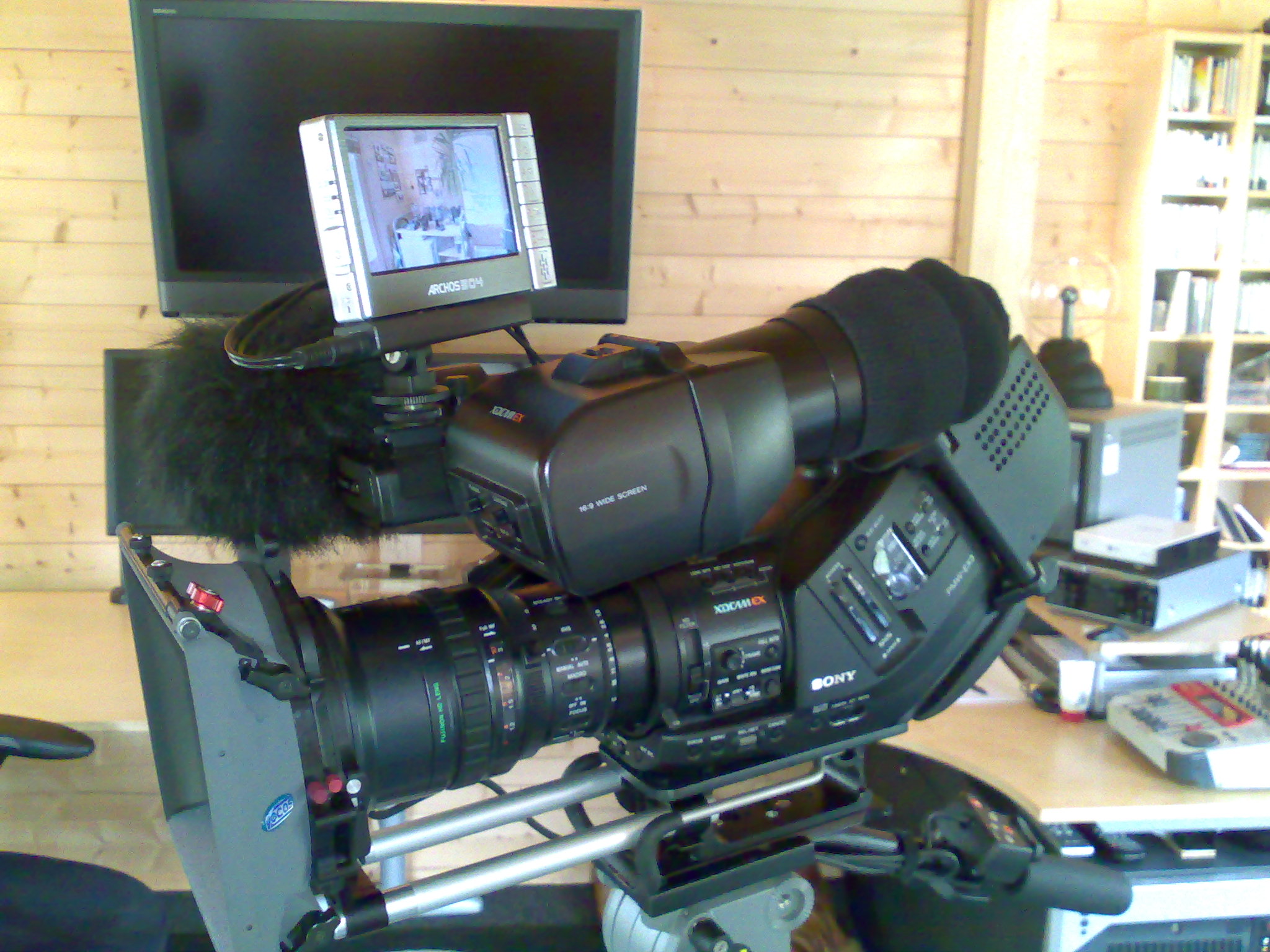

I have needed a monitor for the clients to look at while shooting not a big one but something which a client can look at while standing or sitting next to me during interviews, also for when I use my Track and Dolly, it’s nice to be able to view the picture from the side of the camera while pulling or pushing the Dolly.
I had an Archos unit anyway which I carry full of films and stuff to watch when on long journeys.
I made a bracket up from bits and pieces to fit the front Shoe and some heavy duty Velcro on the Archos unit and bracket, cable hooked up to the Monitor Out on the EX3.
The nice thing about the Archos over an ordinary LCD is with its hard drive I can record the output from the Composite feed and Audio at the same time, why I would need it I don’t know but it’s there anyway.
Made a huge difference to my Tracks.

Great set-up, Mark.
What kind of reinforcing plate is that I'm seeing between the EX-3 and the rails? Can't quite make it out.

It's a DM Accessories plate in Black.
Thanks very much Mark. The plate looks a whole lot sleeker than the unfinished versions I've seen previously.
