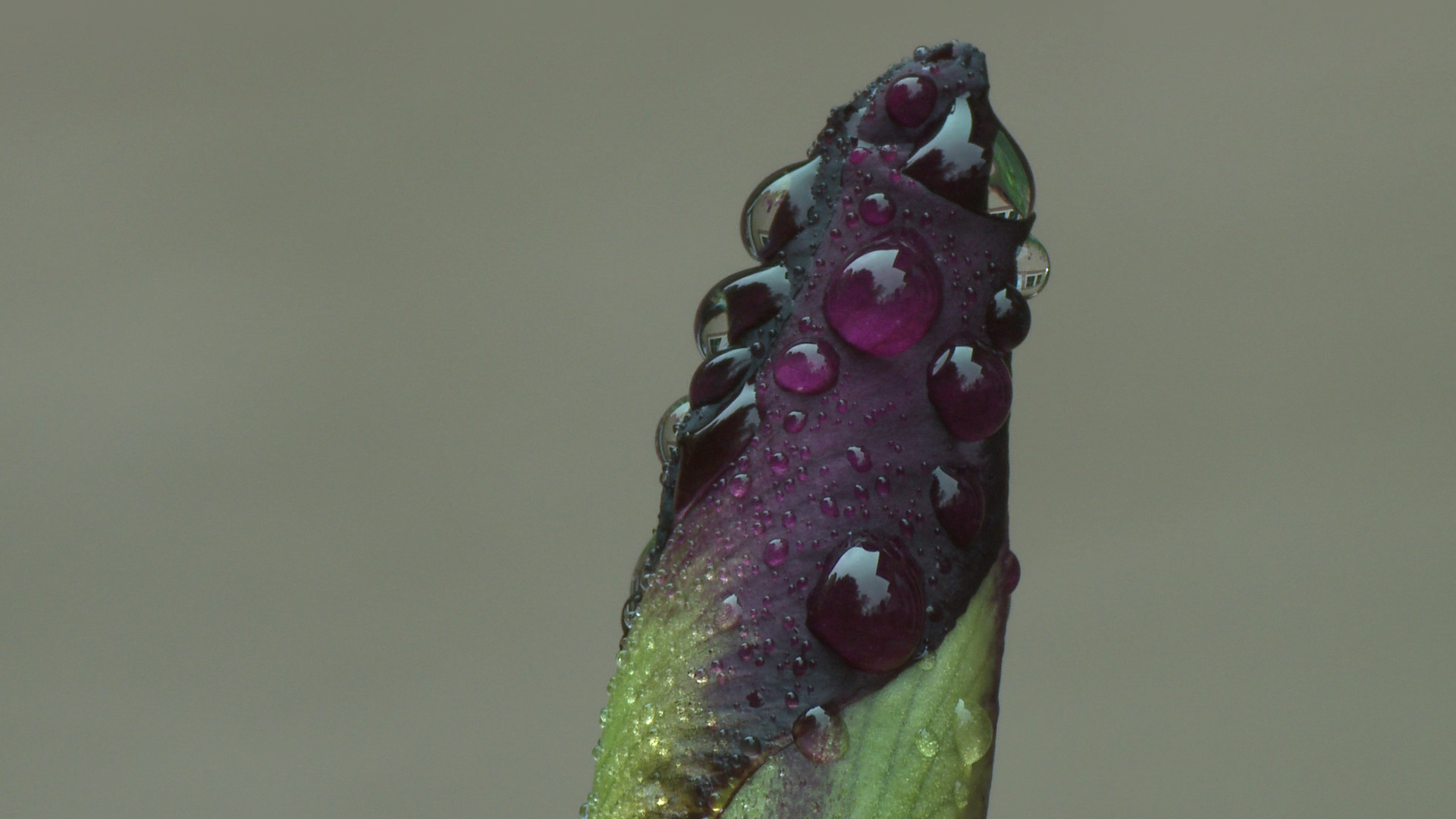

I like the 180mm
One of the many nice things about these adapters is they don't change the aperture or minimum focus distance. I recently used my 180mm about ten feet from the subject for some garden closeups (just playing with the lens).
Micro/Macro lenses on EX3-garden-02.bmp
