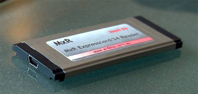

Please find attached our announcement on the release of what we have dubbed the HDR, the Hard Disk Recorder card.
I had planned to make the announcement last Monday of the un-powered version. But we have been researching and testing and have come up with a solution which can draw the power necessary for the HDD or SSD directly from the camera. And because we were so close to perfecting the solution we decided to hold back on announcing anything until we knew if we could release in this round or not.
We're in production right now, and will be accepting orders from 29 June 2009, with a shipping date of 6 July 2009.
As you can imagine we're really excited about this product release, and have put a tremendous amount of time into getting it right.

Here is the link to the EX-V adapter EX-V
Ross mentioned in the press release. The adapter uses BP-U60/U30 batteries to put out regulated 5V for powering up to two HDs or SSDs.

Yes Ronn, the base EX-V adapter is a plate with a cable attached, no electronics. The 5V version of it has a high efficiency 5V (up to 3A) voltage regulator inside.

I'm hoping that Ross will sell just the ..."the un-powered HDR product, one with a removable Mini-USB cable, (HDR-U)" adapter card so I can use my own arrangement for power & SSD.
Ross, do you have a price for your HDR-U adapter card only, the one with the usb socket (plug in my own usb cable, power, etc.)?
This will be a bit easier than modifying a generic adapter card.
Evan

Hi Paul,
We have been testing a number of SSD's and HDD's, and we get closer to full release I'll post a list of the ones we think offer the best performance. I can tell you price and performance are not linked in what we have worked with so far.
We are working next week, on a cover which surrounds the Mini-USB plug, which will protect the camera, but will only be designed for Slot B in the EX1. In the EX3 no problem.
We thought about the idea of having components that users could select which parts they wanted to buy, but everytime we bought a new enclosure or a new cable, we'd end up with performance problems, so decided, if we were going to end up supporting the whole product, we may as well design and supply the whole product.
So what we have gone for is high quality shielding on the PCB in the HDR, high quality cabling, and high quality PCB in the enclosure.
These aren't corner computer store components, they are all designed with one thing in mind, getting data reliably from the EX1 to the hard drive.
The only question in our minds was the HDD itself. We thought that our customers woudl prefer to source that locally, so if there are any warranty issue they can sort them out with their supplier.
We also know some users won't want to even add the hard drive, that's ok we'll supply one, and fit it for a small fee.

Hi Ronn,
We were trying to give users as many options as possible,
1) Power from an external source only, eg our power pack or Alex Dolgin's.
2) Power from camera.
3) Power from external source and camera.
But we only managed to confuse everybody. Sorry about that.
So what we thought we'd do is fall back to the externally powered version for now. Spend some more time getting feedback from our customers on how they want a powered version to work, and then release that at a later date.
One suggestion is to have a switch where the user could turn off power from the HDR if they wanted to, and run on external power, run on both, or power solely from the camera.
Another is to have an internally mounted "top up" battery, which supplies the difference in power between the HDD requirements and the camera's output.
That's just a couple of thoughts that have been on the white-board for a while...
What do you think?
