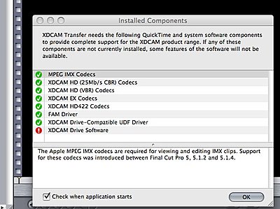

When I start up FCP now, I get a message for "Installed Components" that says something is missing.
"XDCAM Drive Software"
"The XDCAM Drive file system driver from Sony is required to write to a PDW-U1 XDCAM Drive connected via USD interface. This driver is part of the XDCAM Drive Software which is a free download from Sony..."
I see a ton of drivers for XDCAM HD 4:2:2 cams and decks, but don't know which one this is talking about. All the other items in the list are checked green except for that one. I did find a "firmware" update for the PDW-U1 that I can download. Do you think it's just looking for the drive that I don't have?

Old July 16th, 2009, 12:48 PM   #5
Location: Paris, France
Posts: 7
hi ,
here is a direct link to download the 888kb file http://www.sony.ca/promedia/files/Sx...r_v1034300.dmg
try to install driver again .
the attached file show what's happen when you import from fcp with xdcam transfert .
if it doesn't work , try to repair your system disk'authorization with disk utility .
bon courage !

Old July 16th, 2009, 12:55 PM   #6
Posts: 7
I think that you are right , no drive = no driver loaded
