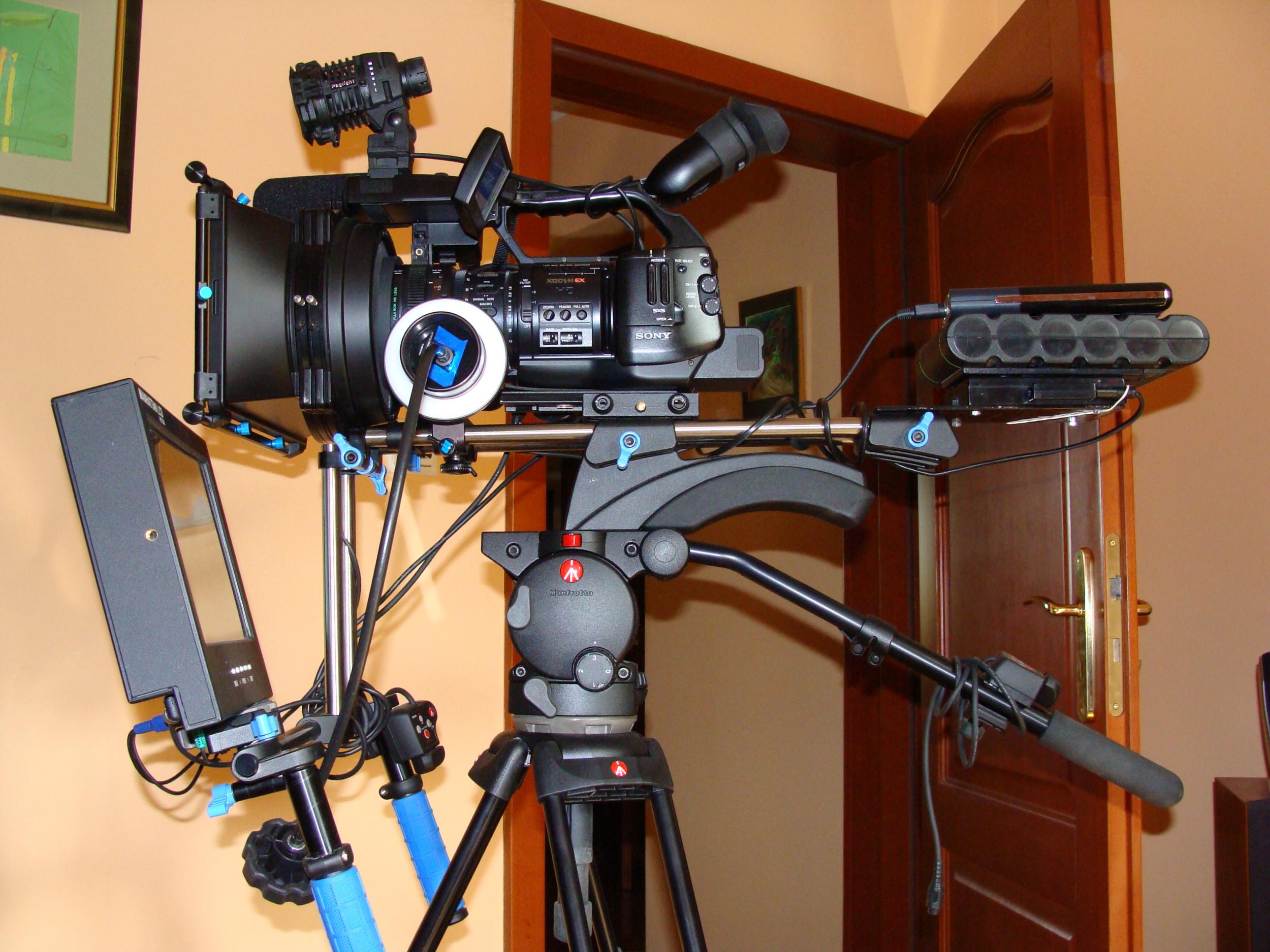

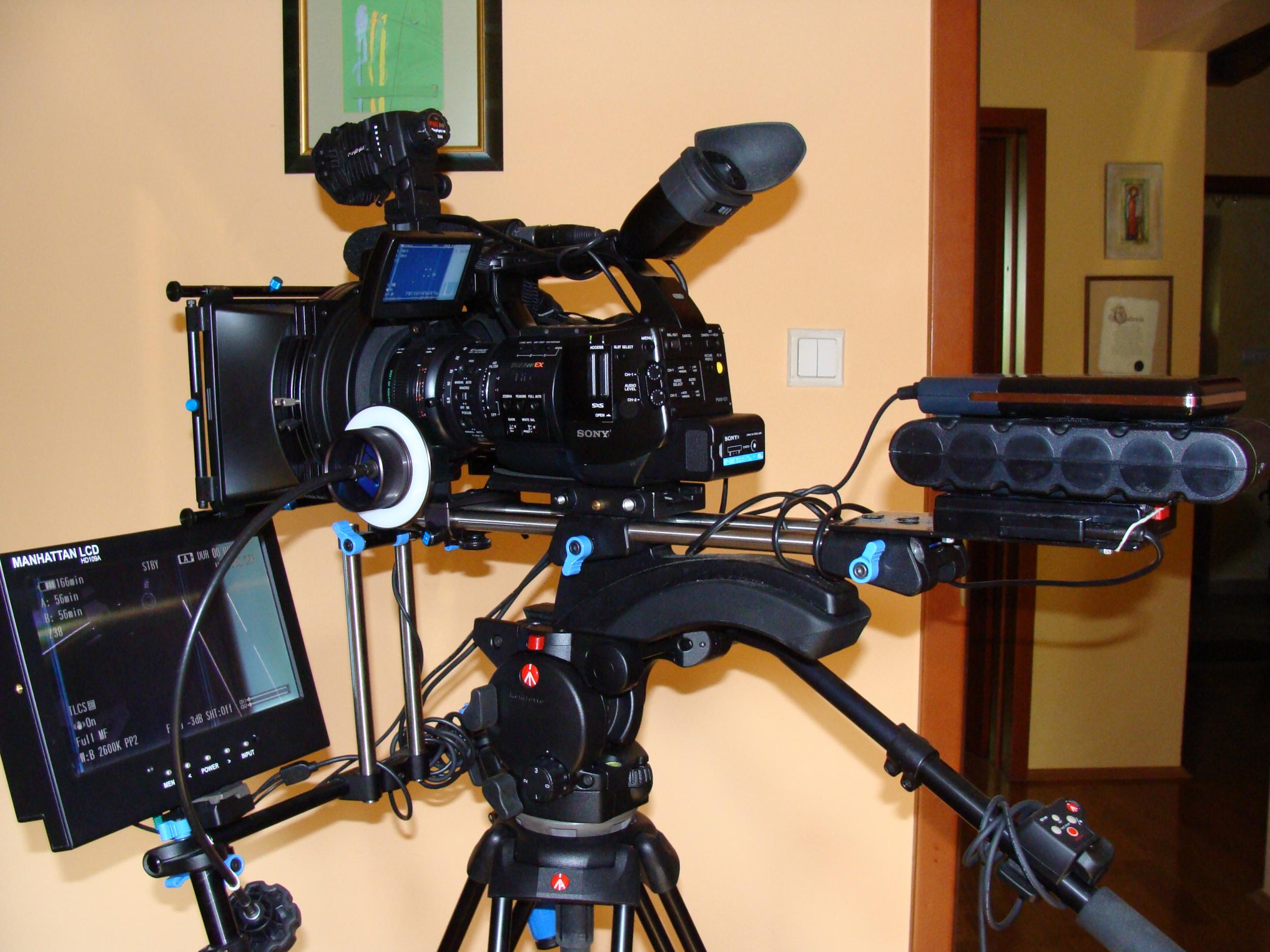

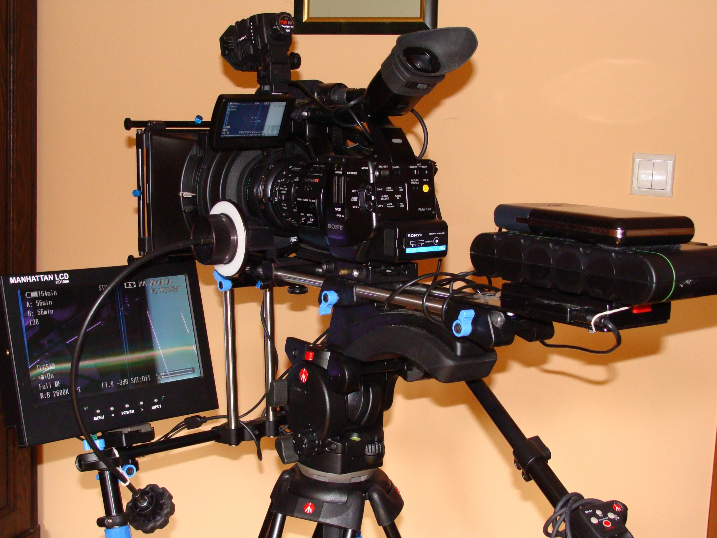

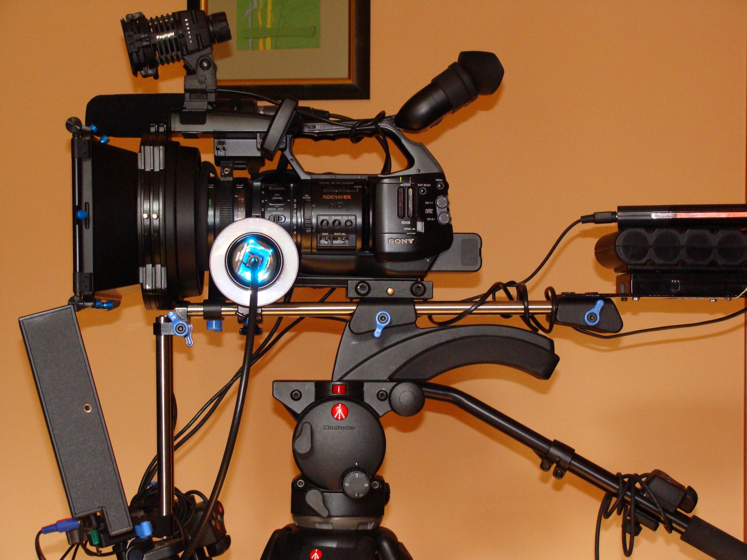

Bob is correct. As promised, 4 pics of my RR shoulder mount as is, after a long time trial & error testing. As you can see, the camera is almost on top of my shoulder (check its position relative to the shoulder pad). With the matte box and monitor, it's still front heavy (even with considerable counterbalance from the PAG battery, Tekkeon monitor battery, and soon to come NanoFlash on top of them). Not to mention my Letus between the camera and the matte box...
Judging from the relative position of the LCD and the shoulder pad, and using your imagination on where my head/eye would be - can anyone advise whether or not the Hoodman Loupe would fit? I guess it wouldn't - even though I wish it would, thus making the rig free of the monitor (which is now obligatory).
The Manhattan 10.9" HD monitor is great when on the tripod, but not with this shoulder mount arrangement!
Good Lord Pitor!! How much does all of that weigh?
In answer to your question (and after my test - which did not come close to reporoducing the actual height of the camera with your system) - there is no way the HoodLoupe will work - just too great a distance and tilt.
So I thought, Barry :)
But I'm still considering the HoodLoupe for my naked-camera, hand-held shootng!
PS. The rig depicted IS heavy, but quite well balanced and actually working...
