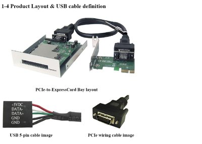

PCIe Expresscard Reader (Front Bay) for PC or MAC Desktop
Has anyone been successful in installing one of the various front bay PCIe Expresscard readers into a desktop and have it work correctly - i.e. fully functional hot swap with the SxS cards? I have installed one in my office workstation - Dell XPS 730x running Windows Vista 64 and my MxR cards will hot swap using the USB portion of the device but with the SxS cards the computer needs a reboot everytime you put a new card in. Once rebooted it works very well with fantastic download times (6 GB in 2 minutes on a test run). There is supposed to be a workaround by going into Device Manage and doing a "Scan for new hardware" but this does not work on my Vista system. There are various theories as to why hot swap won't work on Desktops (either MAC or PC) - the operating system people point the finger at the firmware people and vice versa - but there apparently has been no resolution in either Windows, MAC or Bios. Meantime the customer is left with the choice of either downloading into their laptop with an Expresscard Port or using the USB route with the Sony adaptor which is much slower. Of course, if you figure the much longer download times with USB you still save time by rebooting the computer for each new card. The one I am using is in the attachment.

When you mentioned the other card that died and a power supply, did the front bay or the PCIe card require an external power source? Does your Sigg? I ask because the Koutech's front bay requires a power connection but the PCIe card doesn't.
EDIT: looking at the image you uploaded, your Sigg does NOT require a power source(it must be able to receive it through the cable attached to the PCIe card).

I did a lot of searching prior to buying the card and never came across the Koutech - I can't understand why they would require 3 Sata Cables?? The only thing I can see from the Koutech website is it "Supports eight (8) Status/Control pin-headers for special technical user's applications" whatever that means.
I would steer clear of cards requiring a power supply. Siig does NOT require a power supply and the hookup of the USB portion is optional. There is another card made by "Avlab" that is the exact same card as the Siig only in white instead of black. I did have one Siig card that was DOA but Am.....com is very good about returns.
