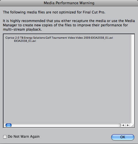

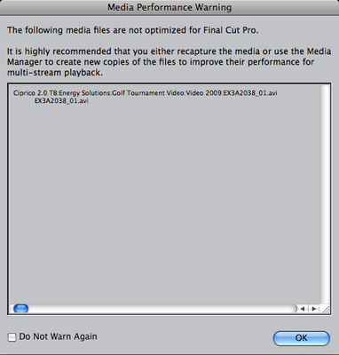

AVI DV = 40 seconds to convert (you were right Perrone!). Quality is virtually identical to DV, but the audio is correct (16-bit) and works in FCP without rendering. But a new problem arises. FCP gives a Media Performance Warning (see attached file) that says the files performance won't be good for multi-stream playback. Anyone have experience with this? When I click the Okay button the clips seem to work fine. Hmmmm..........

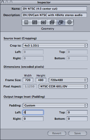

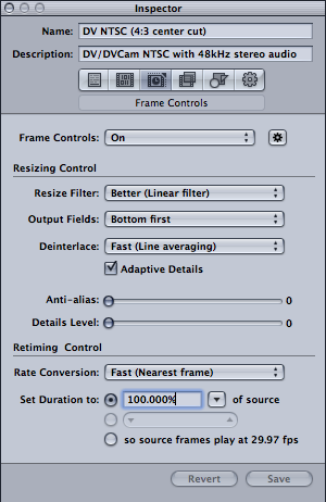

Compressor (frame controls - ON) = 104 seconds to convert. Here's how I set up Compressor: First I started by selecting the preset - Apple>Other Workflows>Advanced Format Conversions>Standard Definition>DV NTSC. Then I changed a few settings in the Frames and Geometry tabs (see attached files). I left everything else the same. The quality was the best with this setting. It looked great. Very good quality SD video in my opinion. It wasn't a lot better than the Clip Browser Export video though. If you are tight on time, then use Clip Browser>Export instead. The key was turning on the Frames controls. Also, don't forget this is Center Cut 4:3 files, so you loose the sides of your 16:9 footage. This is the option I think I'm going to go with.
