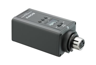

Yes, the plug-in transmitter has an XLR connector on its "top" that plugs into the bottom of a handheld mic.
I suppose you could use a standard XLR mic cable with it as well, but that's not typical.

The plug-on plugs directly on to the mic so I guess whoever named it that was thinking.
The great use of a plug-on becomes clear when you start using it to transmit from virtually anything with an XLR out or other out if you adapt it right and don't have impedance, level, or wiring incompatibility. Press mults, mixer outs, PA speaker loop outs, headphone outs if you are mindful of level. The plug-on should have a settable pad for this use.
Of course, your mic should not require phantom. The plug-on won't supply this.
And if you ever want to use a cable you can but you don't need to.

Here's a pic that should help explain it.
