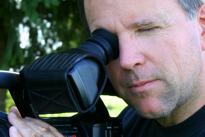

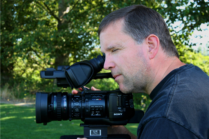

Here are a couple of pics of the Hoodman unit at work this weekend. Overall I have to give it very high marks. Very little, if any slippage once the thing is attached, and when properly positioned I saw no light spilling in. I shot two soccer games and had no discomfort to my eye. It does add some weight to the LCD screen of course, but I don't really feel it's too much to cause harm to the screen's hinge. Very easy to get on and off.
Overall, IMHO worth every penny I paid for it!

Piotr - Look at the first pic from Forrest and extrapolate that if the viewfinder were pointed downward - his face would be snug against the camera body - I believe that is what would happen if you used this with the Redrock shoulder mount apparatus.

Barry - this is exactly why I'm interested in using the Hoodman loupe when shooting hand-held only, if at all.
To help me decide, I'm once again kindly asking anyone having the loupe to post their pictures, showing a person actually shooting with the naked EX1, with the Hoodman loupe against his/her eye.

Piotr,
The handheld positioning of your head will be very similar to the pictures I posted. Because of the EX1 viewfinder in the back you'll most likely need to angle the HoodLoupe upwards so you're ear doesn't come in contact with it and the EX1 handle.
I suppose the disadvantage is that the EX1 will be slightly lower than eye level. But the BIG advantage is that you can push the EX1 up next to your body and cradle it by keeping your elbows tucked in.
With the Quick Release Pro I have attached to the bottom (previous pics) the cradling is very easy by supporting the camera with your left hand under the QRP while still having access to focus and iris. This combo seems to make for a very nice handheld situation. I haven't recorded any footage yet but it feels very stable...MUCH better than trying to handhold the EX1 without a shoulder mount. Also, you can attach wireless mics and such to the QRP. From my early tests this combo may well produce handheld shots that rival shoulder mount cameras because you're using your whole body as a tripod of sorts.
I'm under heavy deadlines now so I'm not sure when I'll be able to post some handheld pics, but hopefully this helps. As I said before, the HoodLoupe setup definitely takes the EX1 up a notch. You can now effectively get critical focus outside without having to block the sun from the LCD or use an external monitor. Great for running and gunning. It attaches quickly, doesn't slip around very much and effectively blocks light from spilling in.
This is a very well designed, well built product and I will be using it a lot!

You're probably right about a true run and gun situation. Due to the nature of most of my work (corporate and medical) I rarely shoot handheld. But it would seem in a little more controlled handheld situation you can use your left hand to support the camera/QRP and still have access to the focus and iris rings with your fingers...not ideal for sure but pretty doable. And, I don't have long fingers!
I'll try to post some pics when I get time, but imagine having the EX1 viewfinder snug against your shoulder, right eye in the HoodLoupe which would be angled up, your elbows snug against your midsection, left palm flat under the QRP and your right hand on the EX1 grip at about a 45 degree angle. It just seems very stable to me, but again, this would be under a controlled situation and not so much in a wedding and/or run and gun news situation. A true shoulder mount would be better for sure.
