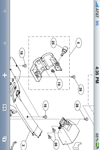

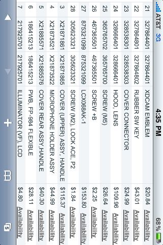

Old October 23rd, 2009, 02:42 PM   #9
Location: Oakland, CA
Posts: 112
Just ordered myself. Here's the diagram and part numbers. Use the third column for the part number. It was a f****** mission trying to get this information from Sony.
EX3 - Mic Clamp Replacement?-img_0261.png   EX3 - Mic Clamp Replacement?-img_0260.png
